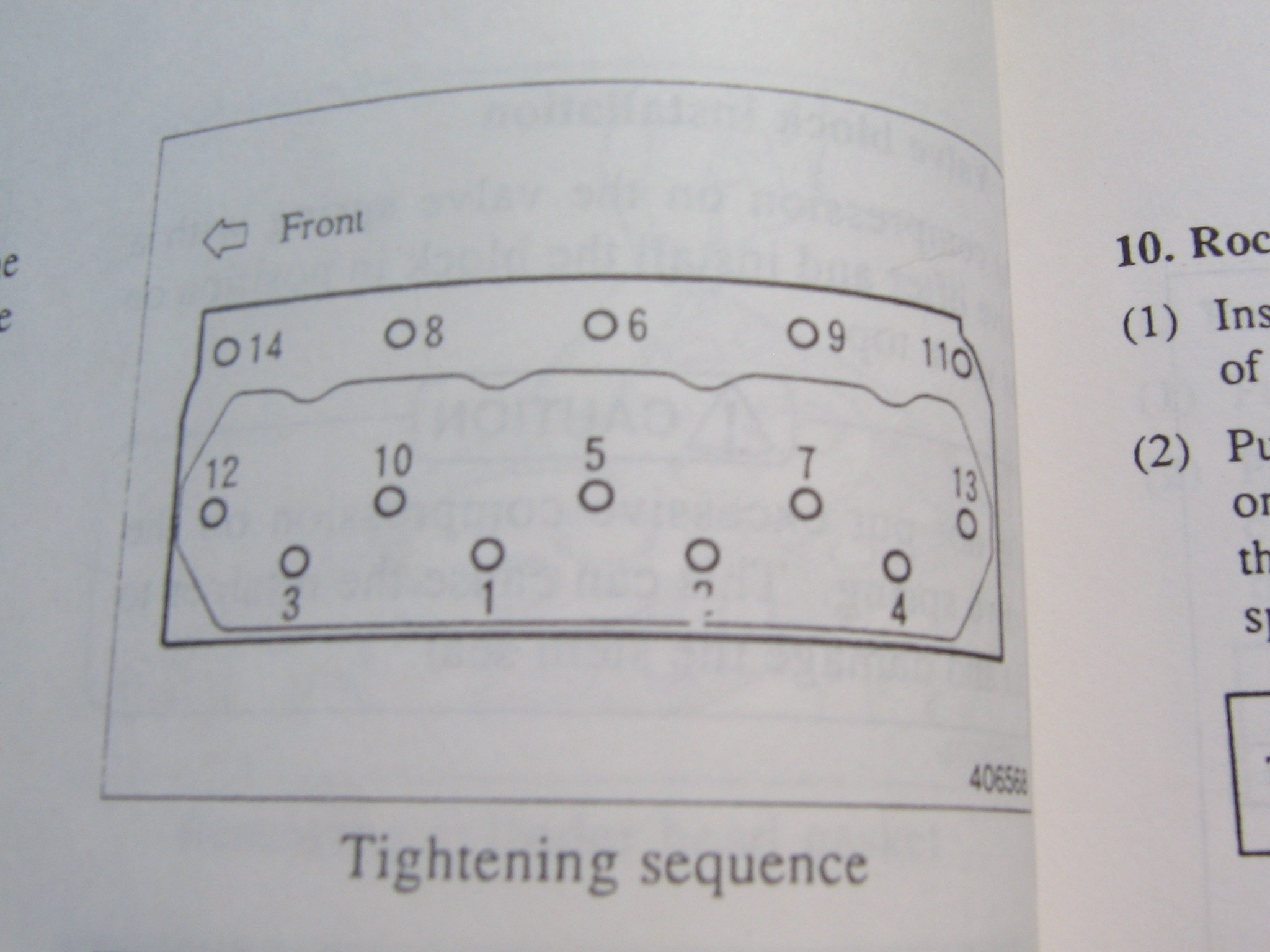

I am a little late with the 400 hour service which seems to be change all the fluids (except the coolant) and filters per the owners manual. In addition it calls for the valve clearance to be checked and the head bolts to be torqued. I asked a mechanic about doing this and he asked about the sequence for torqing the head bolts.
The owners manual just gives a list of torqe values for various bolts but nothing about the sequence. Can anyone shed some light on this? I am still looking for a shop manual but have not located one yet and got no reply to my email to LS about one.

This is out of the service school manual. Cylinder head bolt torque 58+ or - 4 ft. lbs.( 78.5 + or - 5 N-m). Use three steps to reach the torque for the head. Rocker arm torque is 11+ or - 4 ft. lbs torque. Trac

Valve clearance is .010 cold for both intake and exchaust. Checked several different sources for this. Trac
