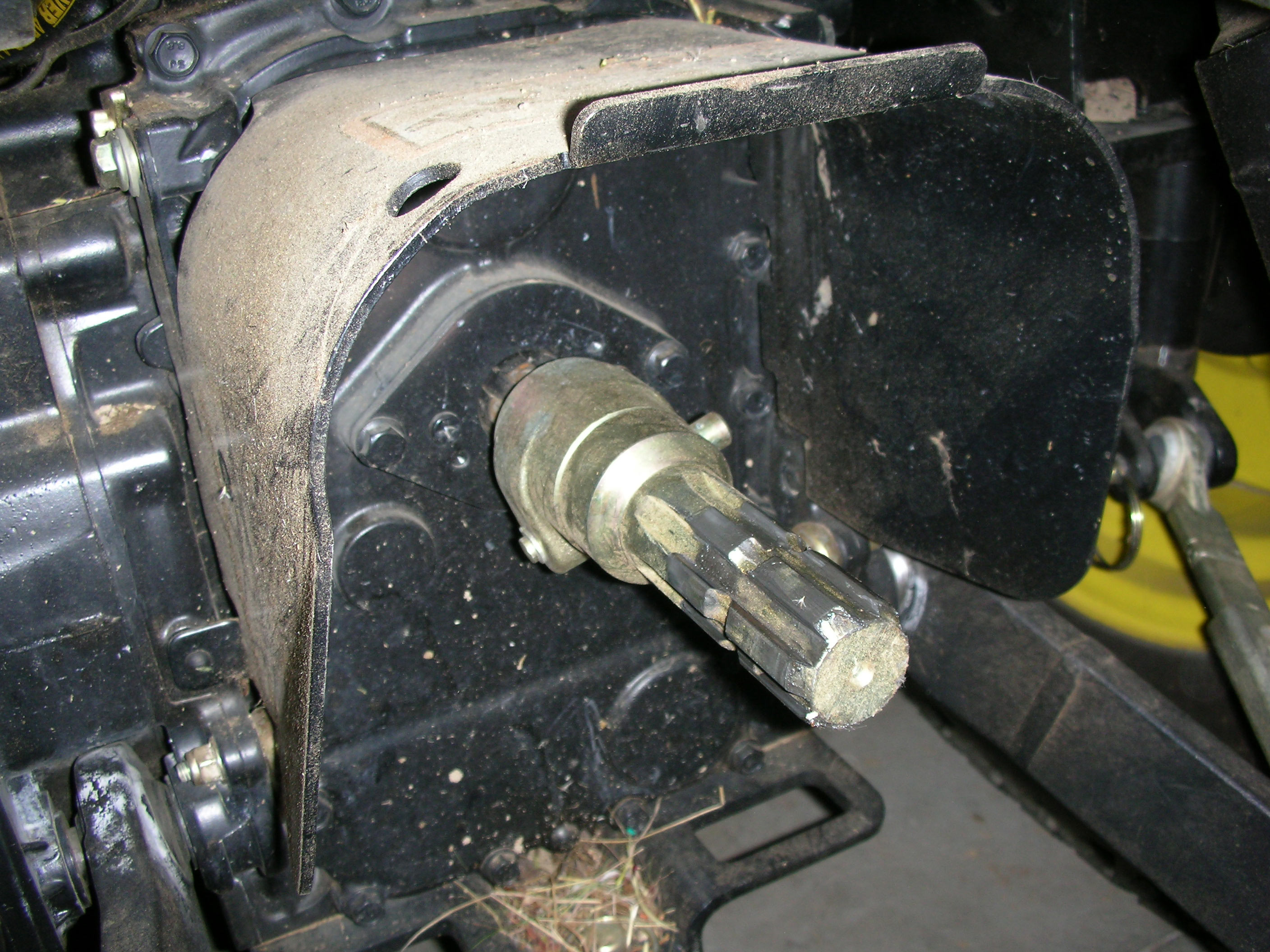

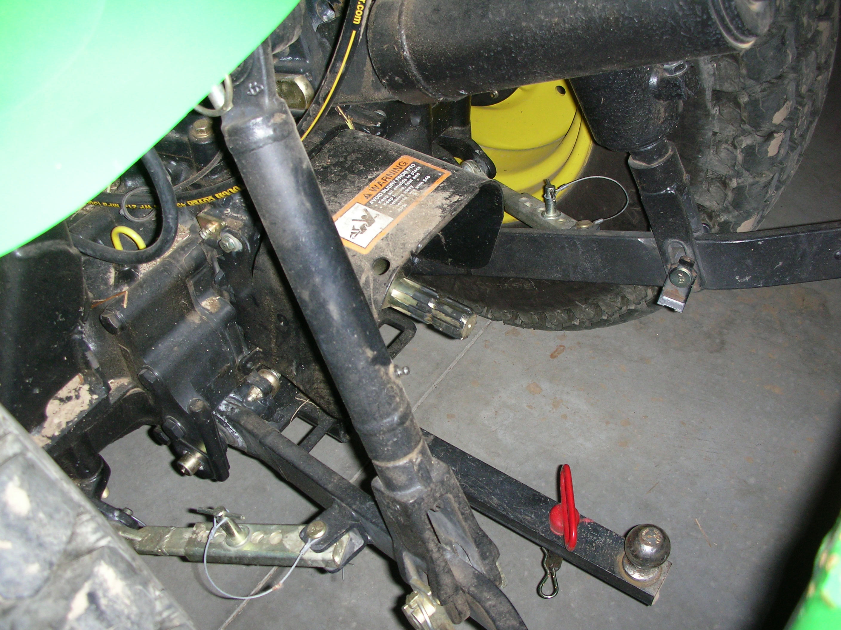

   / 3520 pto hookup on bh #5
Try an extension shaft. I bought one because the pto shaft on my brush hog was too short. It works so well I just left it on and use it for the tiller and the finish mower. Brings the shaft out about 5-6" and makes it so your not fighting the safety shroud while trying to reach around the lift arms and top link.
Please, no comments from the safety police.
Hi,
Another great idea. I had foprgotten they the extensions. I will have too check them out.
