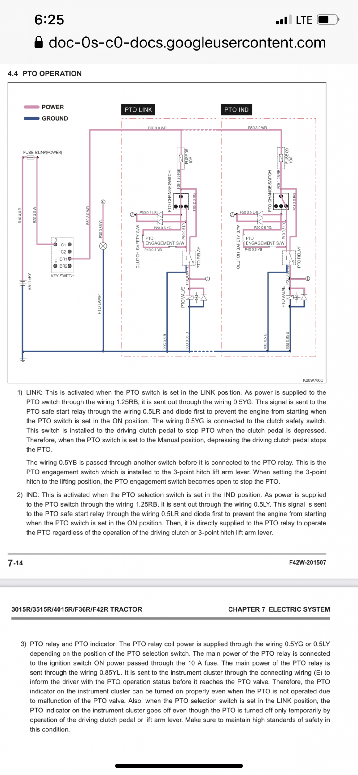

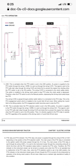

Not sure if you have downloaded the manual or not. Here is a screenshot of the PTO pages.
   / 3510i no electrical power #10
cobb,
Look at the wiring diagram K5 posted. Depending on which pins you're measuring, the 10v maybe supposed to be there.
The "neutral" is probably coming through chassis ground, with a negative dc voltage system.
