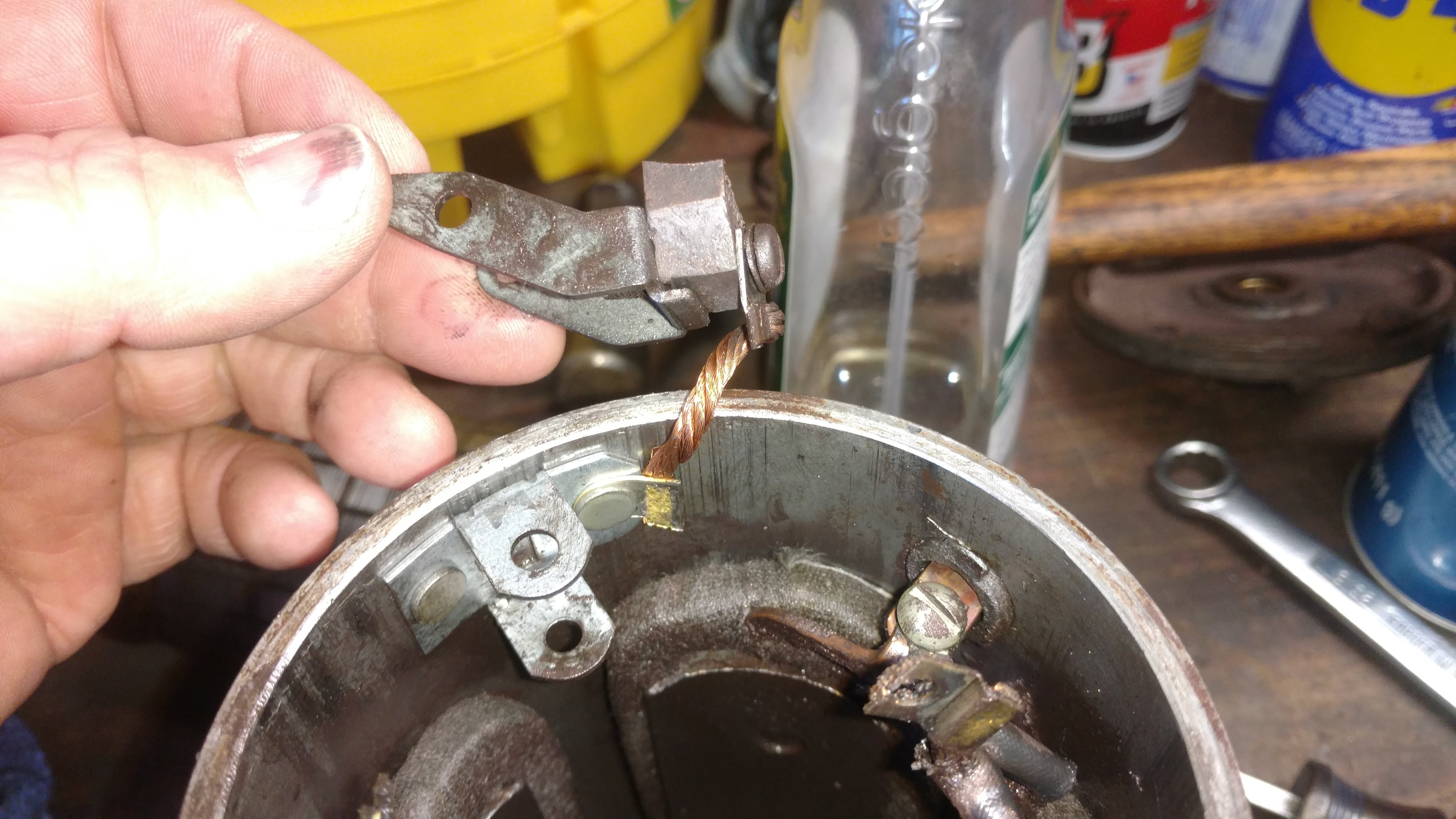

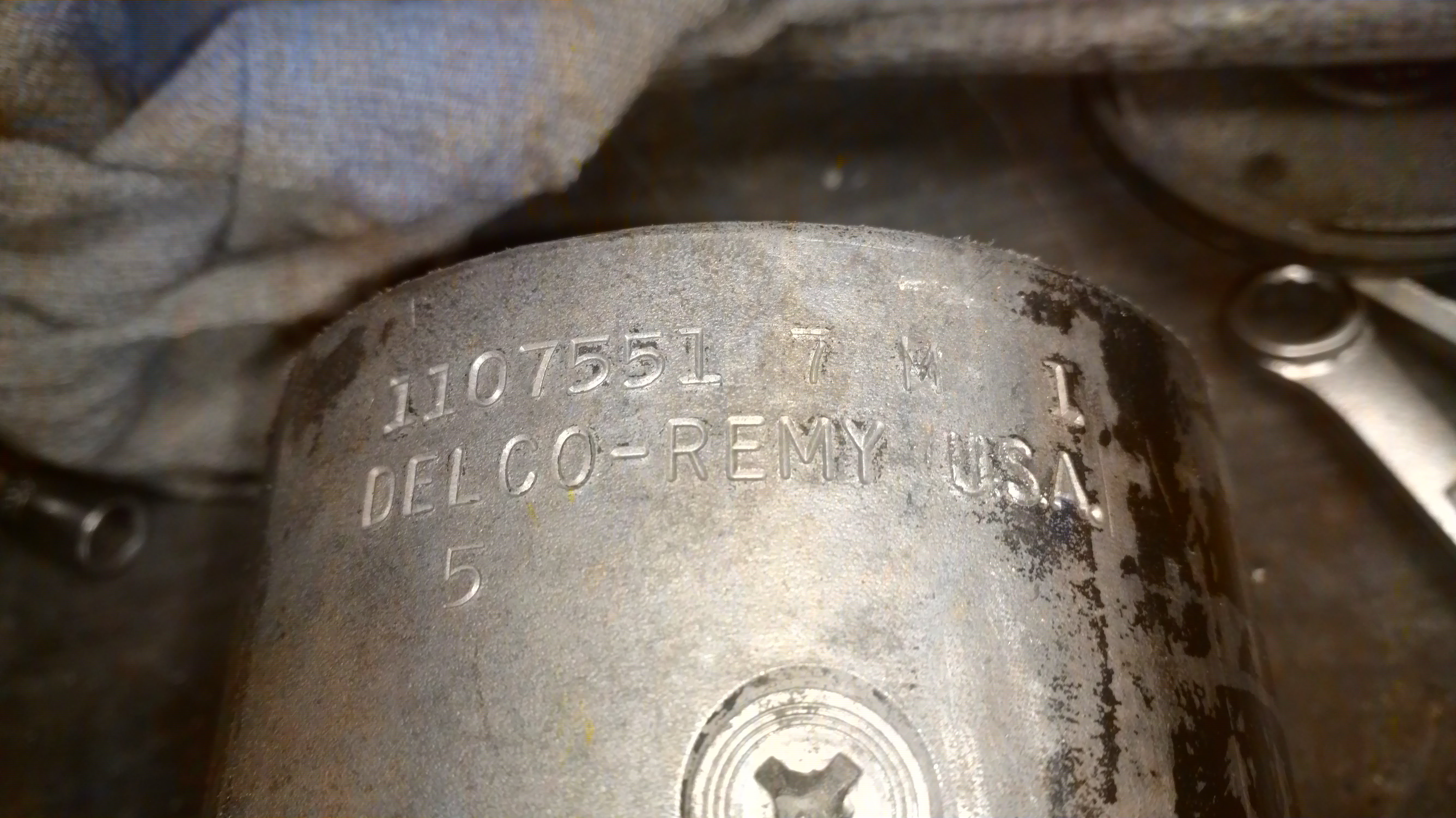

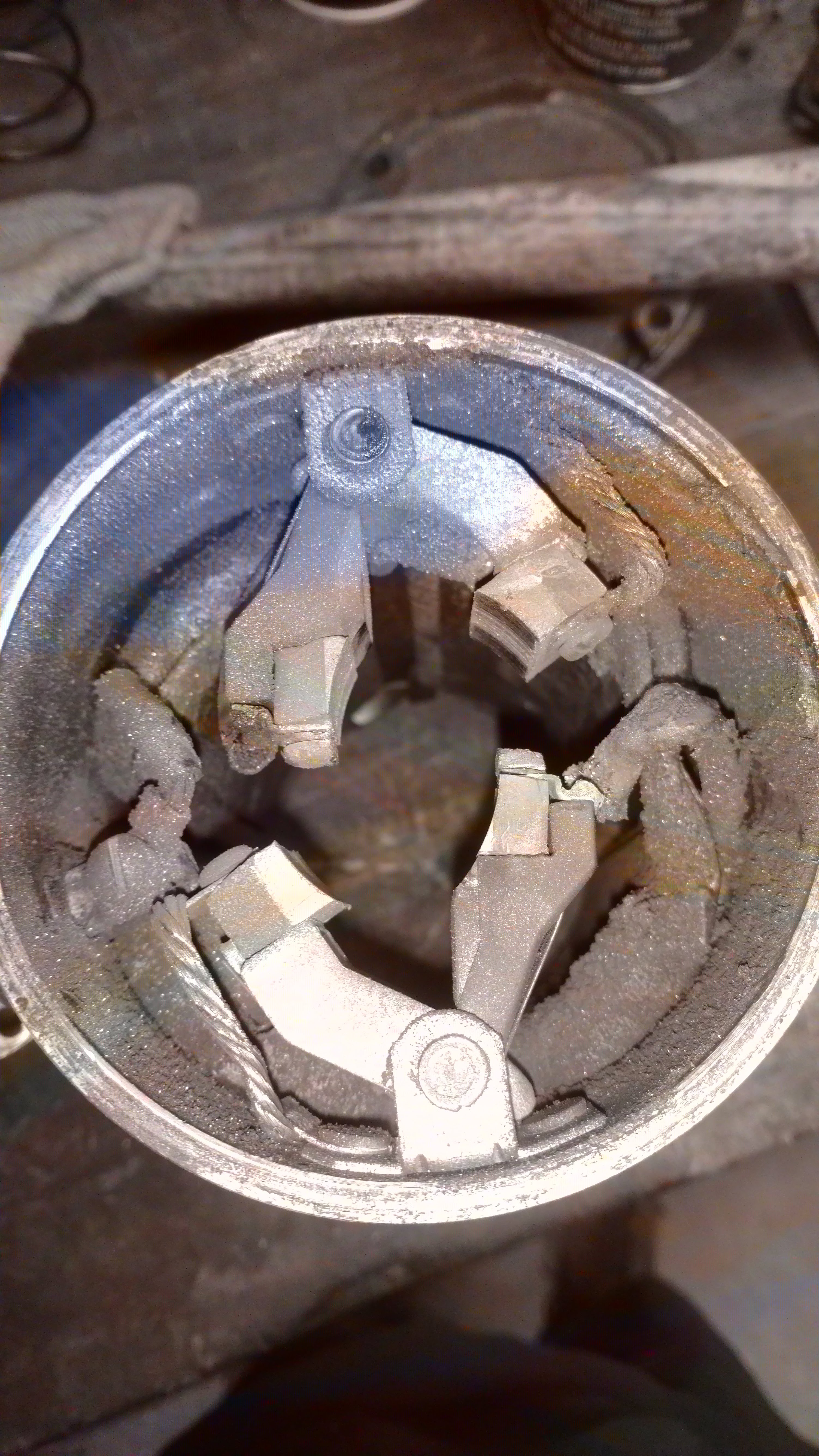

Anybody know the correct starter brushes. I don't need a complete rebuild kit. Just wanted a set of 4 brushes. Starter is a Delco Remy # 1107551. NAPA came up with wrong part. Found some conflicting search results. RX95 's look right, but couldn't find dimensions to confirm.

The part number RX95 was a correct fit. Was able to purchase from RockAuto for under $3.00.. even with shipping it was under $6.00. Made a video of the starter rebuild procedure. I can post a link to anyone interested, as soon as I finish editing.
