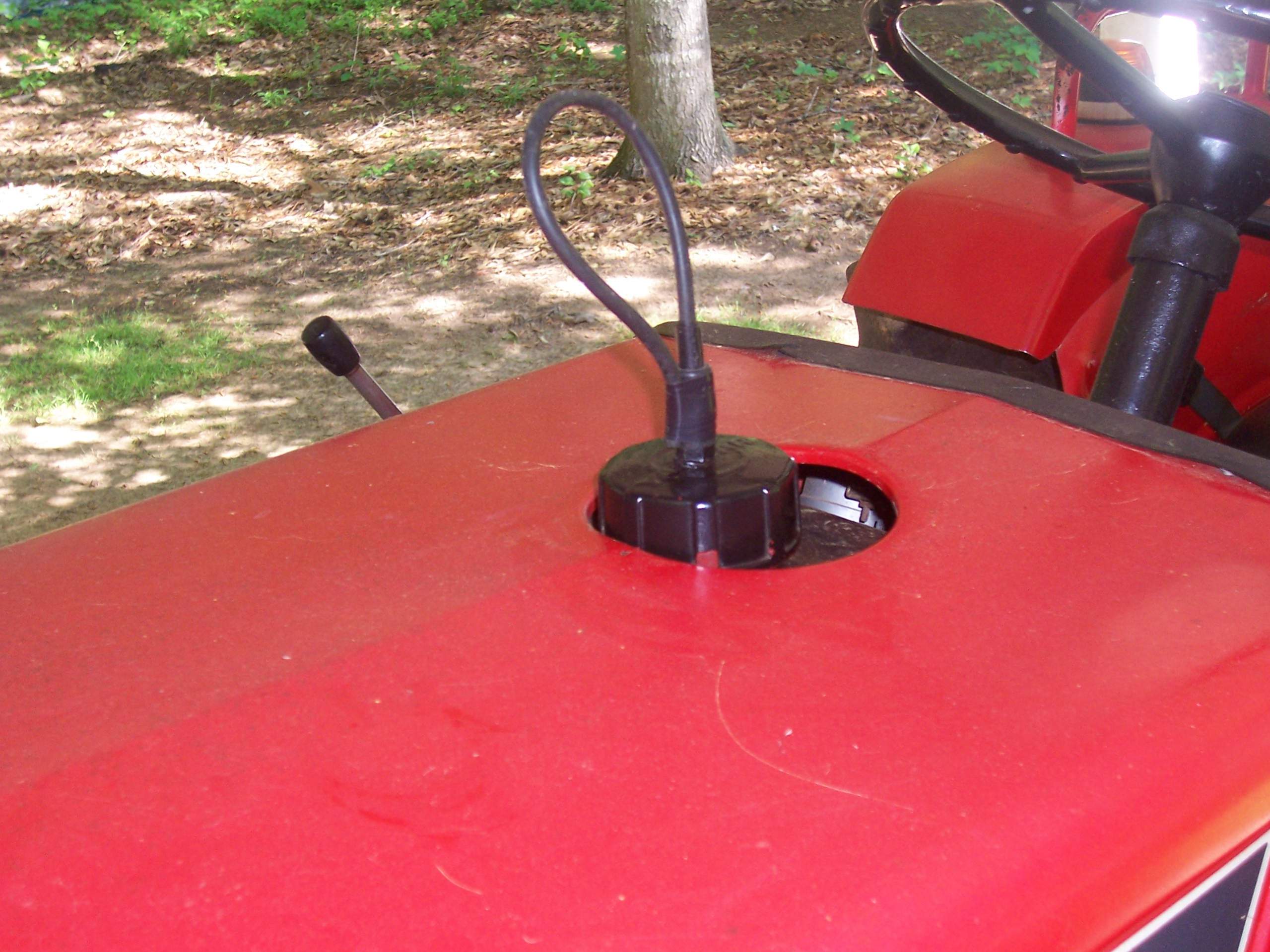

When I mowing one day I seen the air pressure at the fuel return line on my tank. Air bubbles a the connection. I had this vent off an old Dirt bike/ATV. that took care of that problem easily. Works great and been like this for Yrs...
