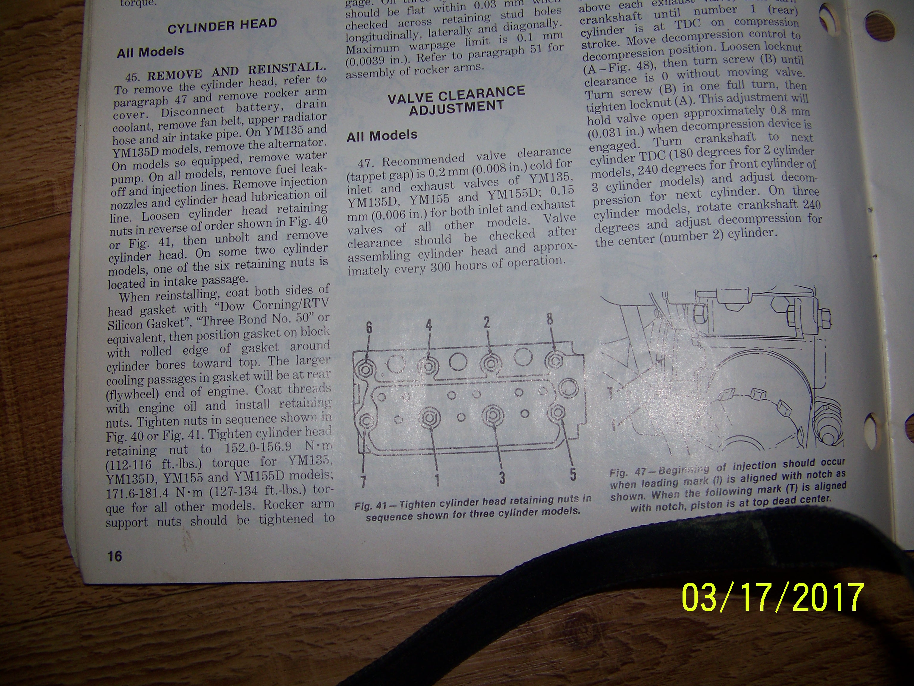

I am going to have to do a head gasket repair on my 336d because of the stupid IDIOT light not working :mad: I did learn an important lesson .... Luckily I can do the work myself but....
I was wondering does anyone has a diagram that shows the Removal and Installation sequence for head bolts ?
I have the torque specs for them and I'm assuming its the X pattern starting from the center and working out toward the end of the head.
I'd appreciate anything you could give me.
also I seen where people had posted .pdf's of the parts book and a few others, but the links were broke when I tried , so if anyone has a copy of any pdf's for my tractor I'd appreciate that as well :cool2:
Thanks in advance
   / 336D Head gasket (Mainly head bolts) info needed #2
Don't think there are any working pdf's left out there for the 336. If you torque as you stated you will be fine. Just do it in 3 or 4 sequences working your way up.
