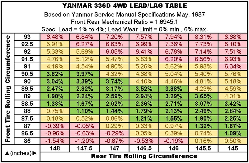

For anyone interested, perhaps this table will be helpful when shopping for tires:
561871d1531153954-336d-4wd-front-rear-mechanical-yanmar-336d-lead-lag-table
Just a quick bit of fun with Excel :)
FWIW per Mr. Steven Sawyer, Sr. Project Engineer at Firestone Ag Tires (successor to Bridgestone Ag in the USA), the specs for the discontinued OEM Bridgestones that came on my 336D when new were:
Front – 8.0-16 Bridgestone Farm Service Lug M, (R1), 6 ply, 1330lbs@35psi max, 6x16 rim, RC:92”
Rear – 12.4/11-28 Bridgestone Farm Service Lug M, (R1), 4 ply, 2216lbs@17psi max, 11x28 rim, RC:147”
^That particular OEM combination would yield a calculated Lead of 6.05%
(not 'obsessing' - just a retired engineer having fun with numbers, it's what we do ;))

Wow!, that's not only mighty impressive useof Excel.... but it actually looks to be useful info, too.
I'm going to go look at the original tires for my old YM336D and see how they fit the chart.
Sure wish I could use Excel that well.

After 500 hours over 10 years, here is what my YM336D measured with the stock tires. Visually the tires didn't show much wear.
The stock tires on my YM336D were Ag tread (R1). Front is OHTSU 4 ply 8x16 Traction Field and Road which is an 8" wide tire on a 6" wide 16" rim. Rolling Circumference measured 90.4 inches at 20 psi.
Rear is a Firestone, also Traction Field and Road 13.6x26 6 ply with is on a 12" wide 26" rim. Rolling circumference measured 147 inches at 22 psi.
Although these tires are different size OEM from the OEM on TX mower's YM336D, my front to rear internal gear ratio is the same: 1.695:1
So by the chart that gave minea stock lead ratio of around 4.28%.
Going to turf tires some few years later required different rims and different tires. Having my choice of ratios to end up with, I chose to make the tire ratio match the internal gearing pretty nearly exactly. Well, I say "nearly exactly", but there wasn't a significant % difference. Real close to 0% lead. The tractor worked fine that way and steered well too - so my guess is that the real ratio was just ever so slightly postitive. The only oddity was with that new 0% lead setup it could then be shifted between 2WD and 4WD at any speed and on the go without a lurch or a grind. In fact, the weight of the 4WD lever would cause it to shift into and out of 4wd going over bumps. It's possible that Yanmar uses a little lead-induced torque "wind up" on the FWD shaft to keep it in gear. I added a hook to keep the 4wd lever from moving on its own.
