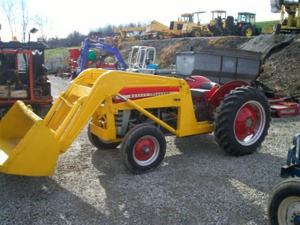

Looking through pictures online and figured something else out. It's a Massey loader, I noticed the grooves in the arms on mine and no Fords have those. Here's a picture of a tractor with a MF32 loader.

Your tractor has a piston style hydraulic pump at the left rear of the engine that has no spin on filter element. Is the loader connected to one or more rear remote valves?

Yeah, I agree it is not a Ford loader. 3 hoses connected to the lift cover means it uses the piston pump I referenced to power the loader. No external filter, check and fill the rear axle center section (separate from the transmission).
