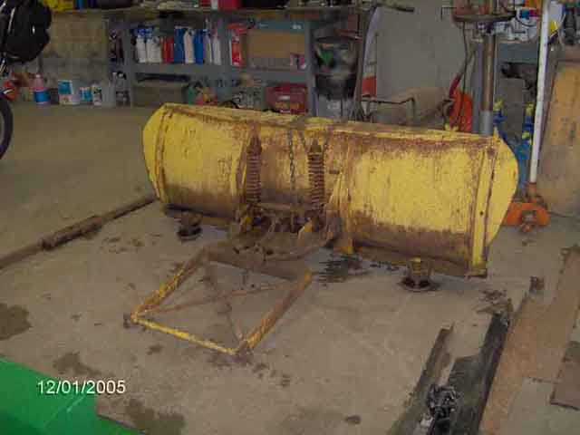

This picture is of an old plow that used to be on my 1952 jeep that's been sitting in the woods for at least 16yrs. It's in pretty rough shape, and I need to make it fit the quick mount on the front of the 300cx?

Here is a pic of the plow mounted on the loader, I used a bradco quick detach fork mount as a starting point for the project. I then made sliding mounts to put on the bradco and used 4 pins to mount that to the plow frame. I made it this way so that I could pull the 4 pins, and put a set of homemade forks on the bradco and still be able to adjust the forks from side to side.

Here's the finished plow all painted

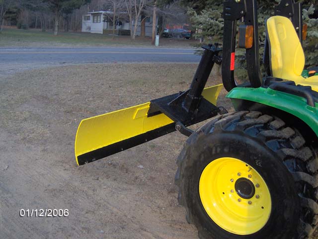

Here's a picture of the old back blade that my dad gave me that's probably as old as me. I had to completelly reweld the cutting edge top and bottom, and also the mount that holds the frame on the blade, it was so loose and broken that it chattered when I used it. I wish that I would have taken a pic of it before the repairs and paint job.

You did one heck of a job on those plows, they look beautiful! I know there was a lot of hard work between <font color="blue"> this picture is of an old plow ... that's been sitting in the woods for at least 16yrs </font> and <font color="blue"> here's the finished plow all painted. </font> Did you sandblast them? It sure looks like it. Very nice.

Thank you John D. wow with that name you should own green! But anyhow, I cheated, since we never know when we're gonna get snow I had to do a hurry up job on the paint, I used rustoleum and gave it about 3 heavy coats with a brush. I wanted to paint it with my spray gun but with the harley in the garage,,,,,not a chance! I did that once and thought that I had the bike completely covered, then one of my buddies put a fan on the work bench to blow the fumes out of the garage. Can you imagine the look on my face when I pulled the sheets off my orange bike with all of the white overspray on it? It took alot of elbow grease to get it off. I need to build a small shed with heat to put the bike in, but that's not in the near future I guess. Thank you for the Kudo's on the tractor I really appr. it! Have a great week!
