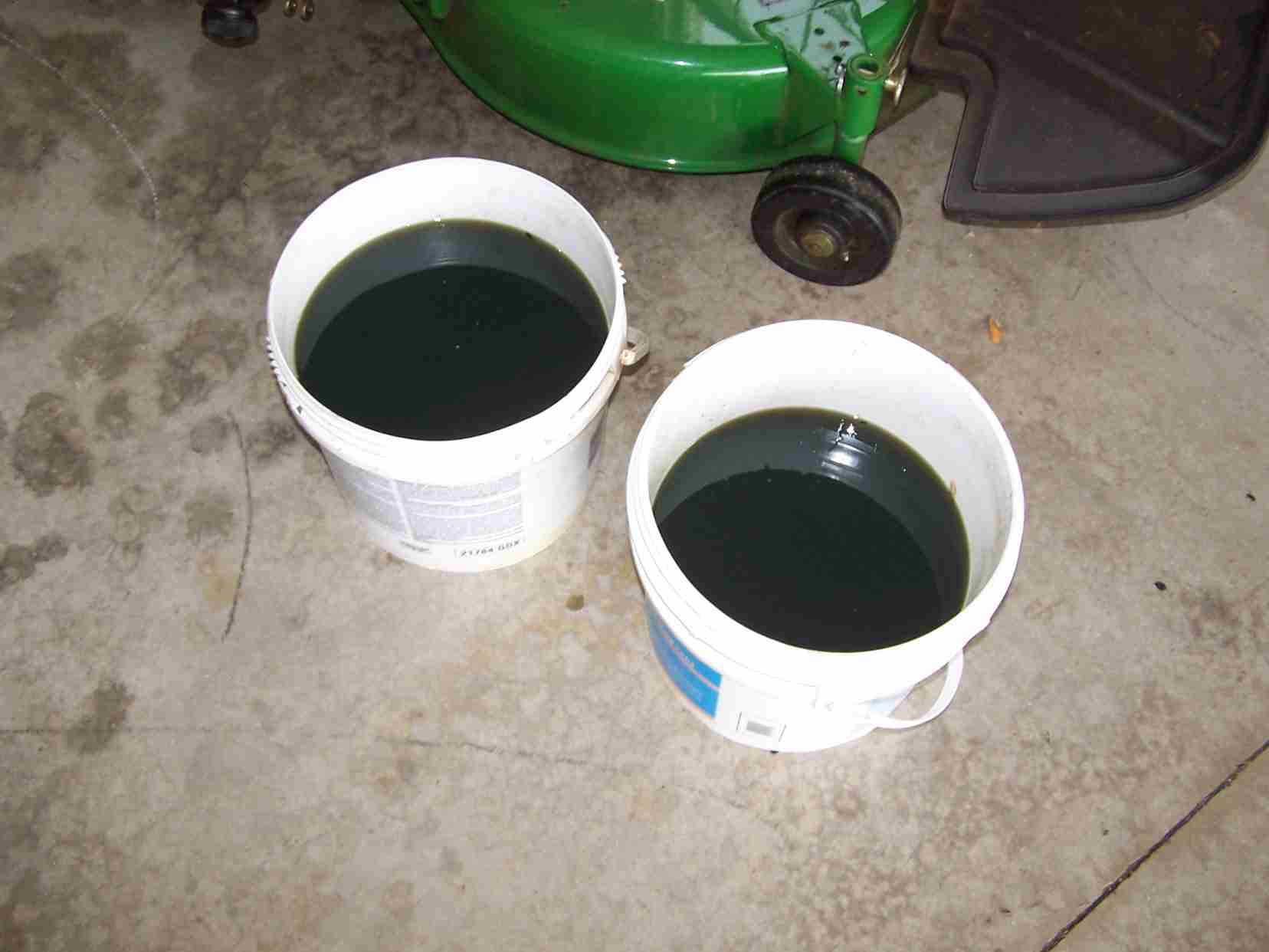

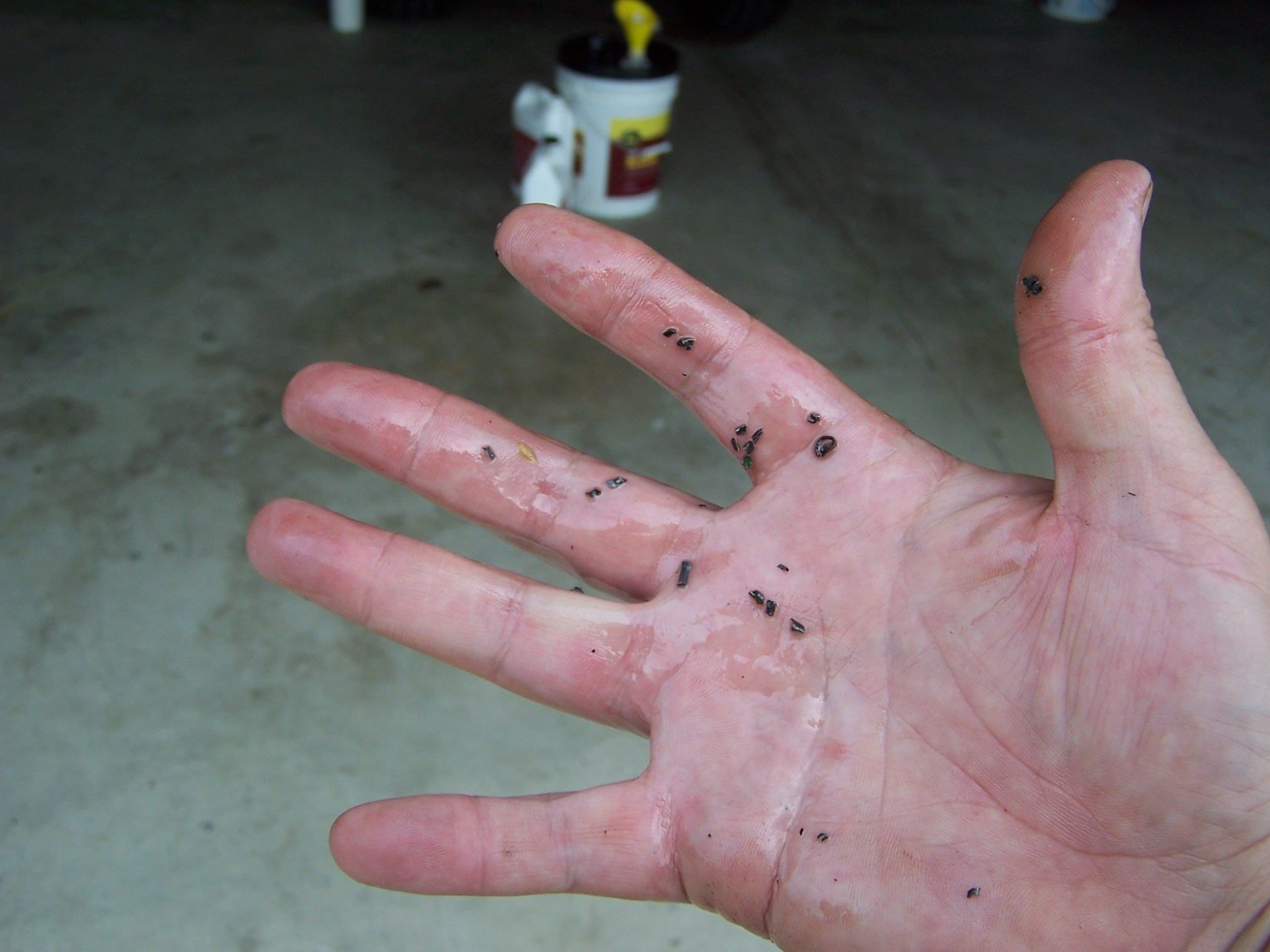

Yes. Up until the shavings popped out, it looked like a big waste of time. Everything else was completely kosher.

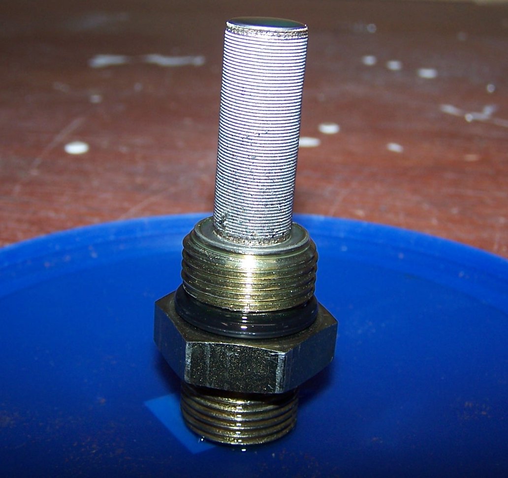

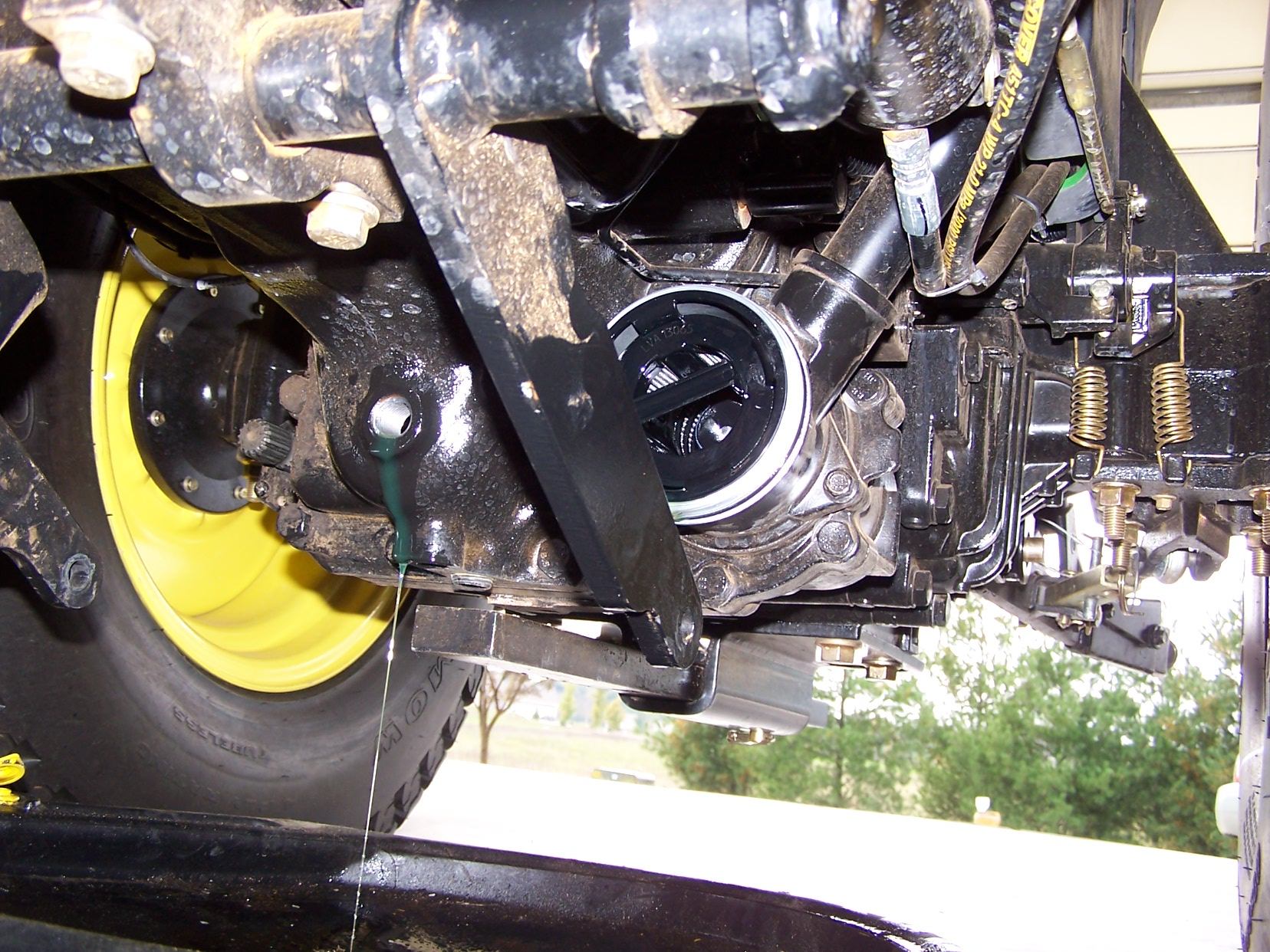

The strange thing is that these things were sitting right at the center drain hole. I mean they came out immediately as the plug was removed. I wonder why? The plug is not at a low point, and it's not magnetic. Could it be left over from tapping the drain hole for the plug? That would be odd. Has anyone else run into this?
Just another of life's little mysteries, I guess.

Found the same when I did the front axle on the 3520... I suspect it's the manufacturing process that particular subcontractor uses... or I should say their lack of clean-up/deburring/polishing during production...
An option is to fill the front axle with kerosene and drive around for a bit with the 4wd to stir things up, then drain... could repeat even if you seem to have worked a significant amount of things up... or just go with it (I did).
