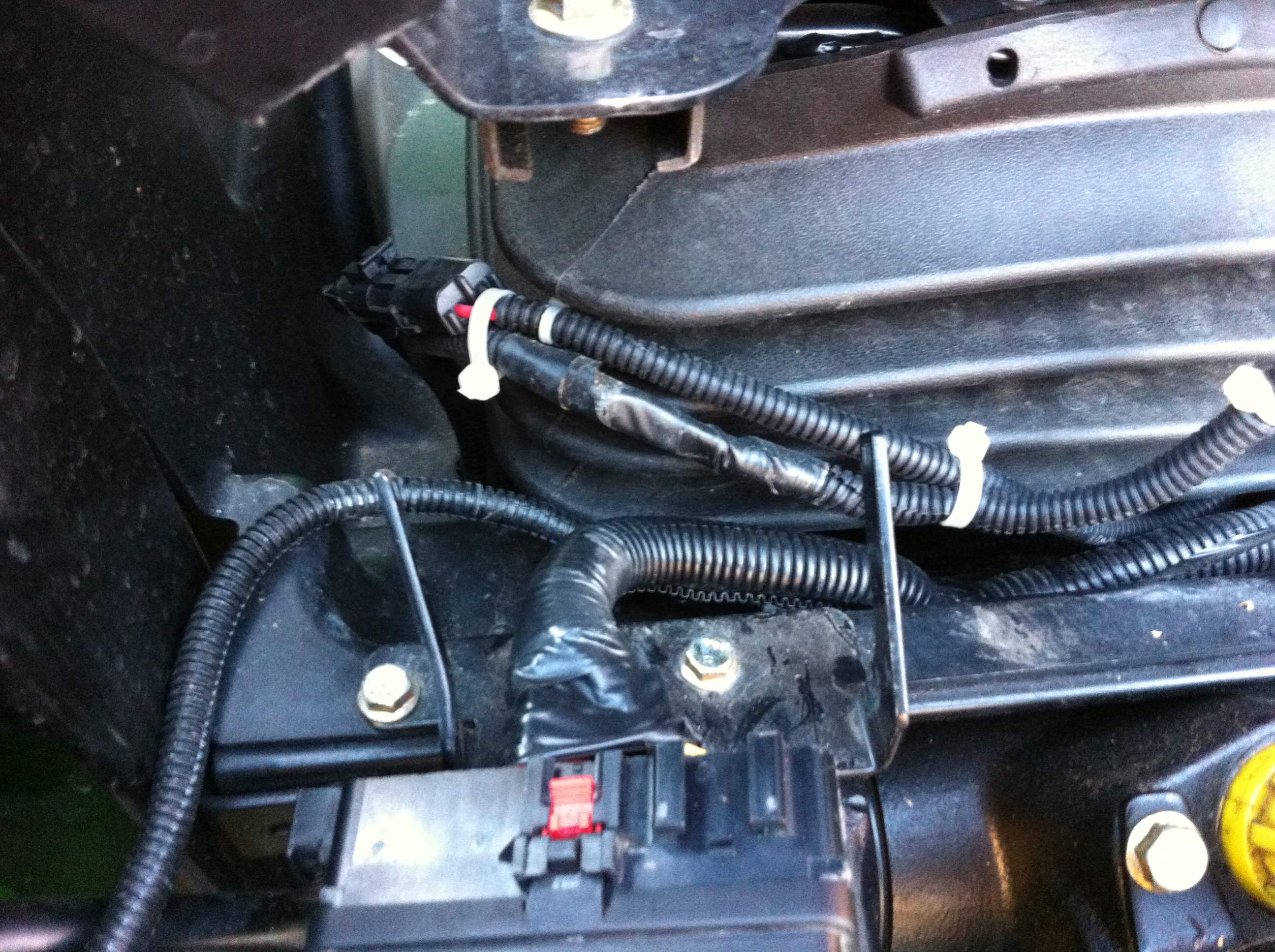

We purchased a used 3320 with low hours a few months ago and all has been well. We had about 25" of snow to clean up after two storms that rolled through back to back last week. During cleanup I noticed the front blade would stop working, so I would turn on the rear-hydraulic switch again and it would start working. It started happening more and more frequently, and then eventually stopped working completely. I have the joystick with the grey up/down switch on the side. The fuse is not blown for the switch, just wondering if anyone has any suggestions as to what may be wrong.

Kennyd, thanks for your help. I found out that there was a fuse block that I wasn't aware of behind the seat when I started tracing wires, and both of the fuses were blown. Now when I replaced them, one of them blew again, so I have to try and take a closer look at what could be causing it to keep blowing. Thanks again!

When you replaced a fuse and it blew that means the circuit is drawing more current than the fuse is rated for, usually a short to ground.
Best way to find it without going thru a bunch of fuses is to rig a 12 volt light bulb across the fuse terminals. Now the light will be the load instead of a fuse blowing. When you find the and correct the short the light will go out.

Zebrafive and kennyd, thank you very much for your help. With some nice weather yesterday I spent some time tracing the wires and it was right near the fuse block. The ground wire had chaffed against some metal and worn into two pieces, as well as one of the hot lines. I noticed that the fuse block looks like it was wearing improperly and there is a bent piece of metal where it is supposed to hold the block in place (see pictures). Does anyone have a picture of what this is supposed to look like to I can try and fix properly. Thanks again for the help! photo 2 (1).jpgphoto 1.jpg
/ 3320 Rear Hydraulics Problem #10
Sorry I can't help with pics, but I'm glad you ID'ed the problem!
