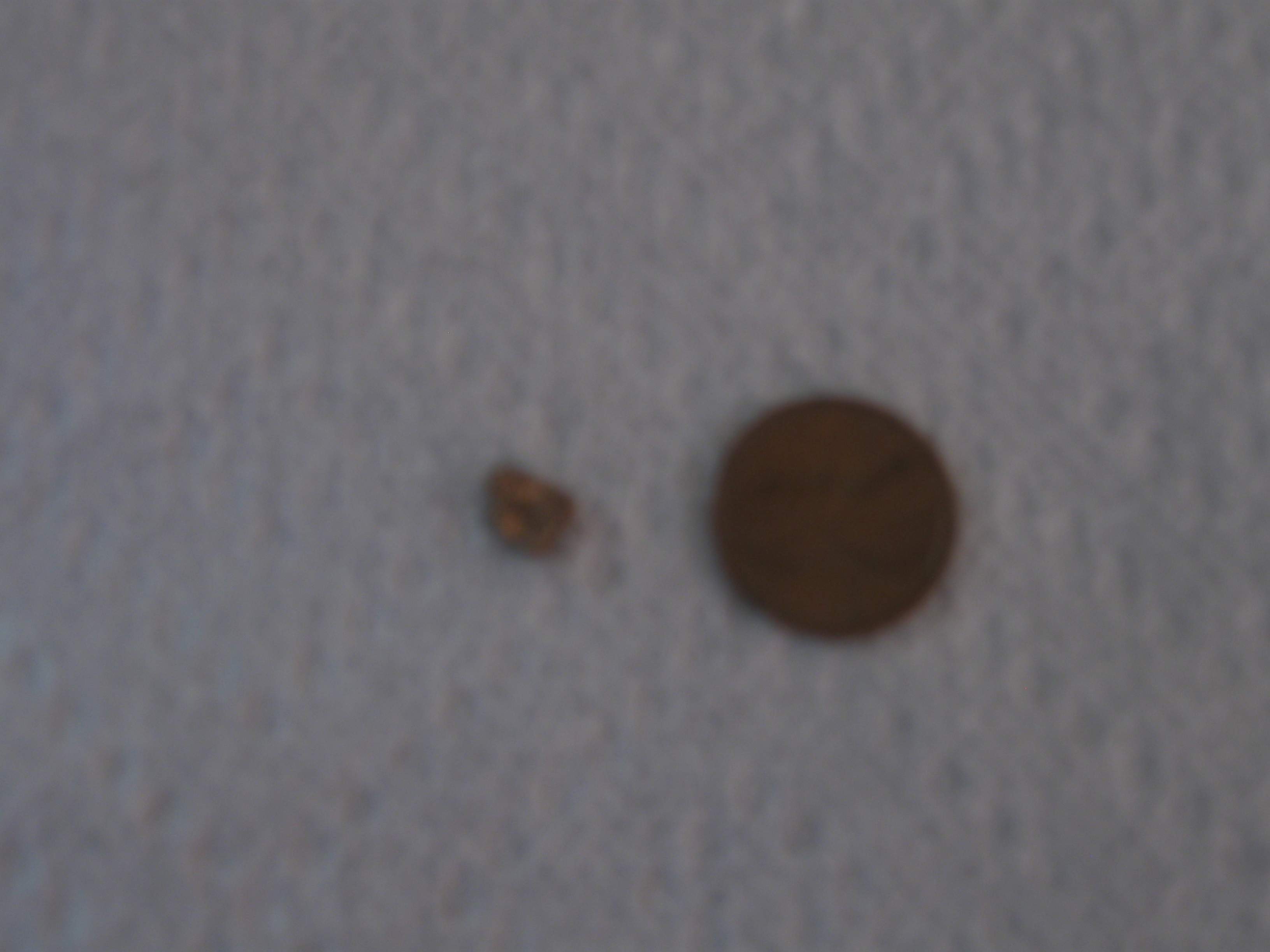

Which brings me to today, I head out to do some boxblading and raise the hitch control handle. No movement of the hitch what so ever. So I check all the usual suspects. Linkages,oil level etc and find nothing. I pulled the PB sintered filter to make sure it was intact. It was but the filter chamber was not filled with hygard. So I knew the issue was before it in the rockshaft assembly. So after the disassembly I find a small piece of the sintered filter jammed in a port of the valve. It was blocking the shuttling of the spool itself. I was relieved to find no damage to the shuttle itself. This piece of debris was obviously floating around in the circuit all this time since the current filter is intact. I'll post some pics in the am. If anyone has details on cutting and pasting from the JD parts site please PM with the instructions.

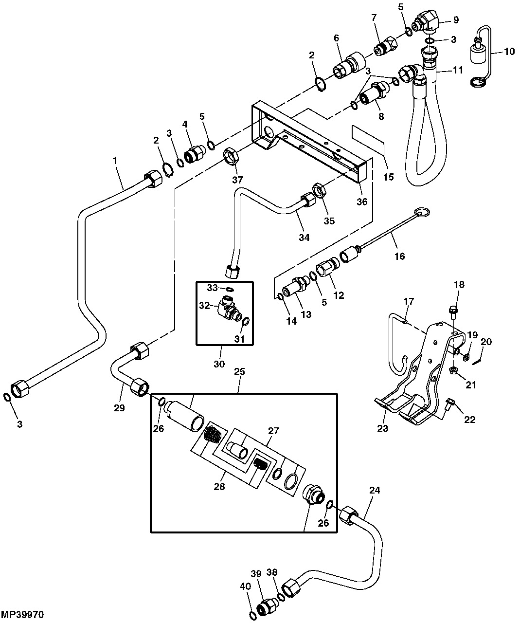

I've snapped a not so great pic of the debris. It's part of the sintered filter, part #27 on the part diaghram. Cinder, are you saying Deere is recommending not using the PB filter? I talked to my dealer about the issue and he swears he's never seen on of those filters come apart. Since this all started after the PB install I'm thinking a piece of debris got into the sump during the install and then made it's way through the loop back to the filter and destroyed it. There's not much to the Rockshaft valve itself so if your mechanically inclined I wouldn't hesitate to do the work youself. I'm betting this would be of 1k of shop time at the dealership. I've placed a penny next to the debris for size reference.

I have never heard of that filter coming apart either except in your case GWH, I have to suspect your theory is correct, the guy installing it damaged it somehow (dropping it maybe?), or it was just a defective filter from the start.
Glad you got it fixed, hopefully for the last time!:thumbsup:
   / 3320 3pt hitch not lifting
The filter itself is quite brittle so if it was dropped I could see it failing. I believe this was the last piece but you never know.
