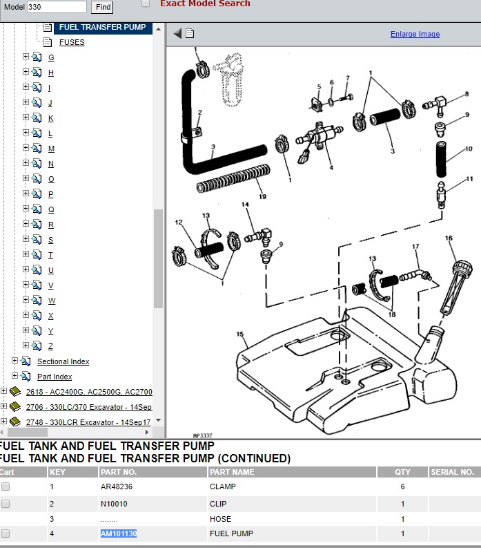

Look into the fuel pump for the 330.. ( key #4) apparently a sub is AM876266. $250+ on GreenPartsStore, $110 on Amazon, and several other electric pumps listed with that part # for less than $25. No idea if they do the job, but may be worth looking into.
