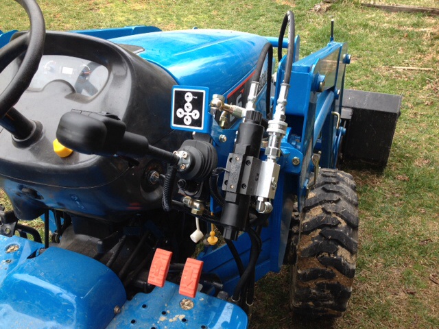

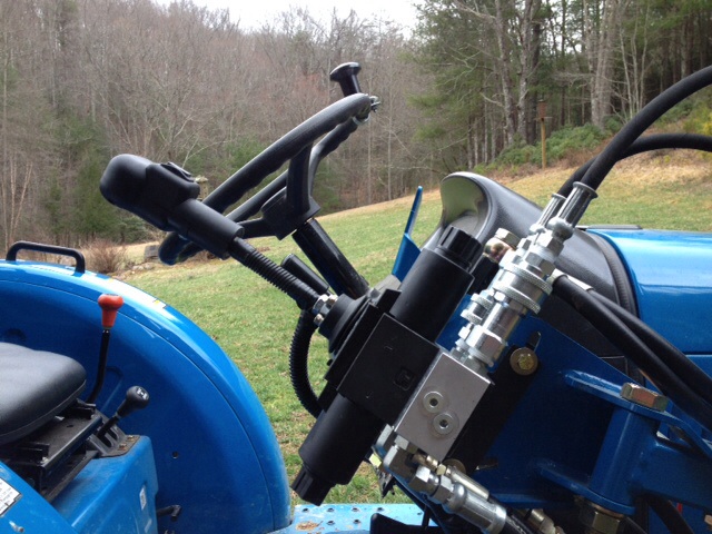

Got the kit from WR Long. To me, they had the most ergonomical replacement grip with a rocker switch that I wanted. Also their mounting bracket was specific to my loader and not some put it where you can find a place for it. Got one miss matched coupling that was quickly replaced by Nelson. Have to say this was probably one of the quickest installs I've ever done. Probably less than two hours and that was fighting with the cat playing with the dangling wires. Hardest thing was deciding the routing for the hot wire under the dash. The G3038 has a spartan dash but LS probably only has one wiring harness, so there were a couple of plugs not being used behind the dash. First one I tested had voltage only with the key on, so I tapped into that blank plug for the electrical. Worked first time and no leaks so far. Ordered a 60" grapple from Titan 3/13 and tracking says it will be delivered afternoon of 3/14(today). Not really holding my breath on that one.

Awesome info. Any pictures??
