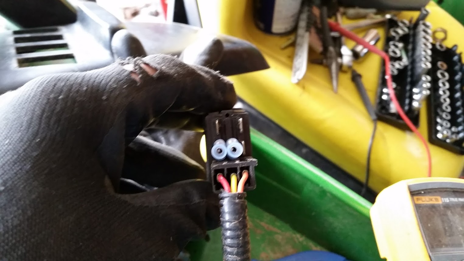

Basically what I found is that the PTO switch and the PTO solenoid are not directly wired together. The PTO switch only seems to send a signal to the cluster, there is no relay in line so it must be controlled by a ASIC on the board.
Here are a few pics of what I did:
Pin D (left purple wire in picture) on this connector was always hot, this feeds 12V to the PTO solenoid.The connector is located on the top left side of the cluster.

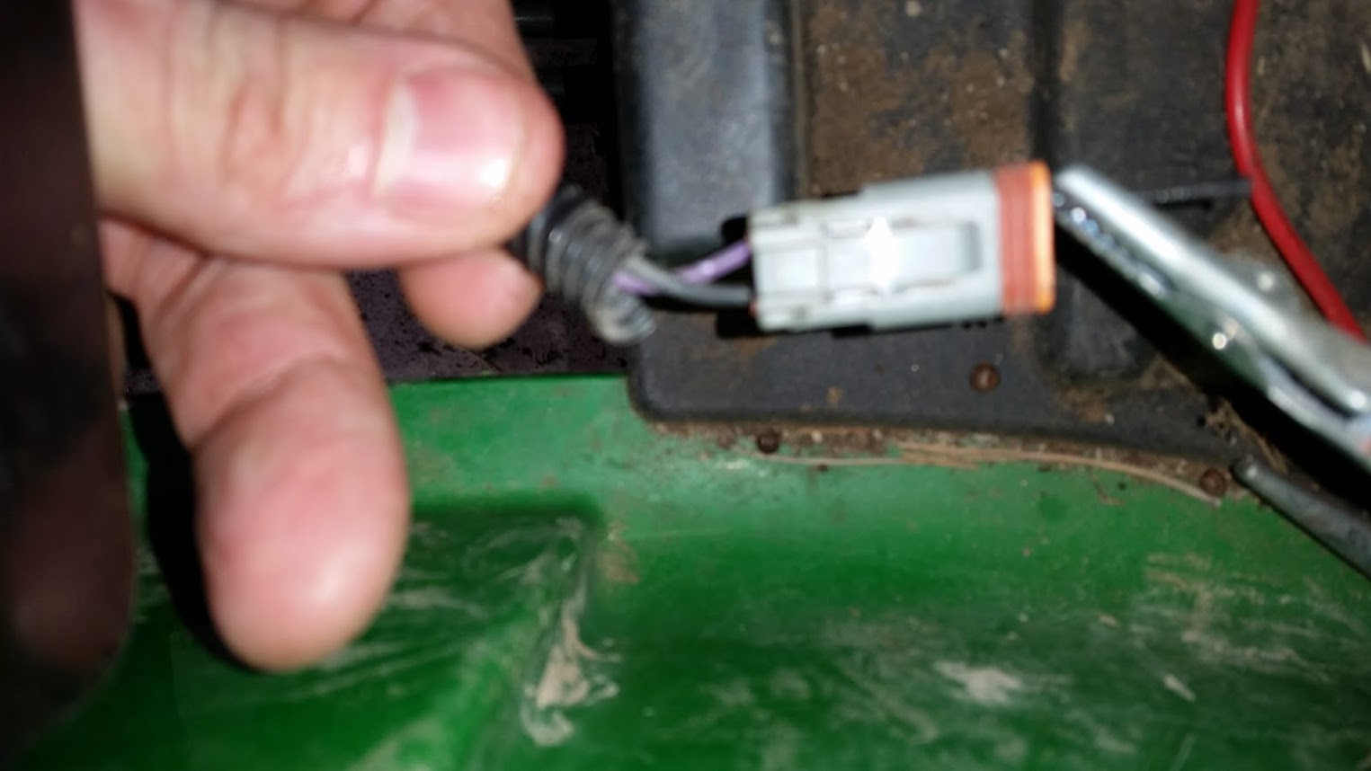

This is the connector at the PTO solenoid, you can see the same purple wire:

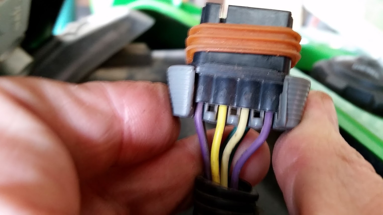

I simply cut the purple wire about 4 inches back of the connector and spliced it through the PTO switch (note the trimmed connector):
Its not the best solution, but it got me up and running. Functionally it is no different, but I sure would love to know why its doing it.
