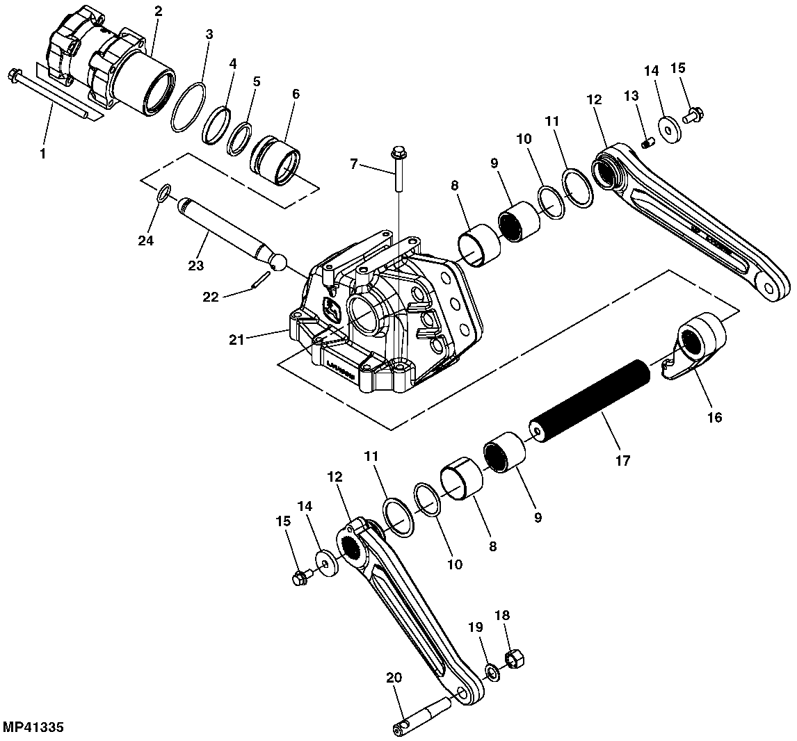

There should be a rod connected to the three point lift arm at pin #13 in diagram. Make sure it is connected there and also connected at front of linkage. If it is unhooked, it will react as you describe.
