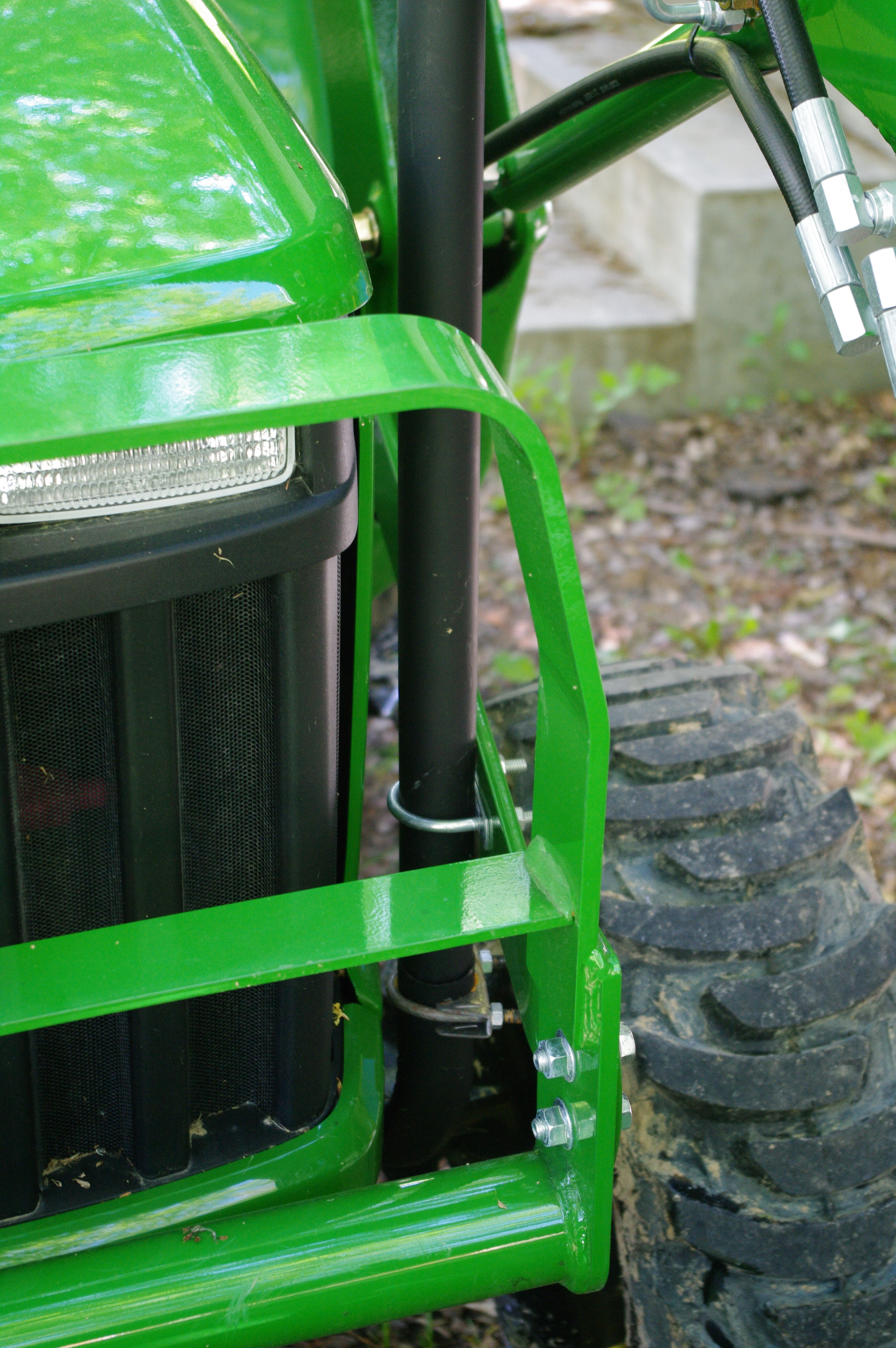

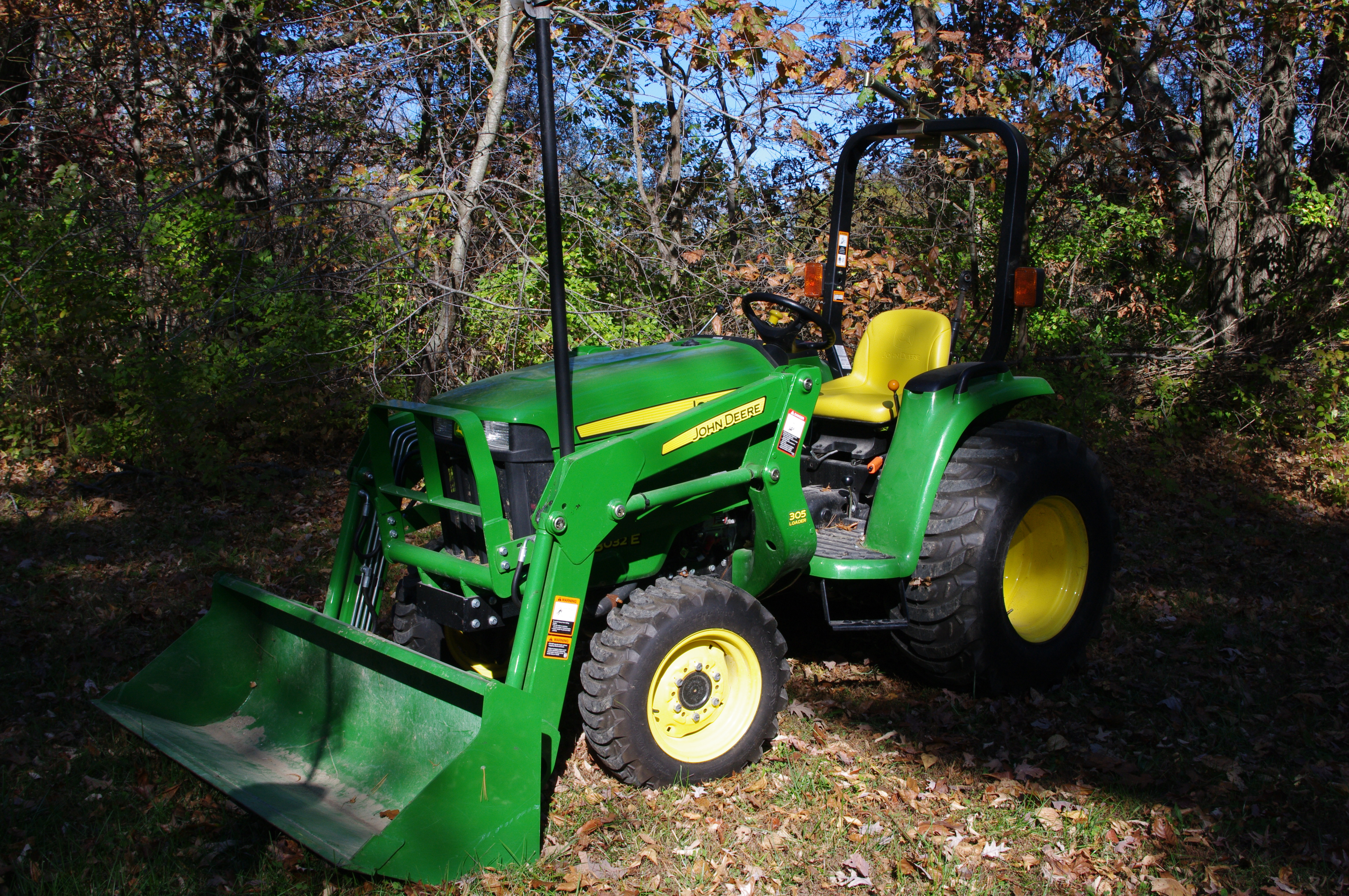

I went to the autoparts store and bought a muffler elbow, then to rural king for a chain link fence piece & flapper.
[no muffler shop in this county rolls their own any more, they have all gone to pre-bent parts.]
Drilled two holes in the loader brace for a mount point & muffler clamped the upright to the elbow [and elbow over factory exhaust].
I made the 'stack' long to go above the umbrella shade [gold mount on rops]
I did use BBQ paint on the new parts.

I'm sure that gets the exhaust out of the way. You'll just need to watch for low-hanging tree branches and such.

Glad to see those u-bolts fastened to grill guard bracket, that way when he finds the low branch or shed door, etc... it bends the stack and not the exhaust manifold.
