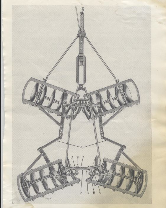

I think that a pull type disk small enough for a 2000# 25 pto hp isn't built unless it was something similar to a JD KBA disk which are known for their limited penetration.. I think a 5 ft 3 pt if put in the ground will load it.
