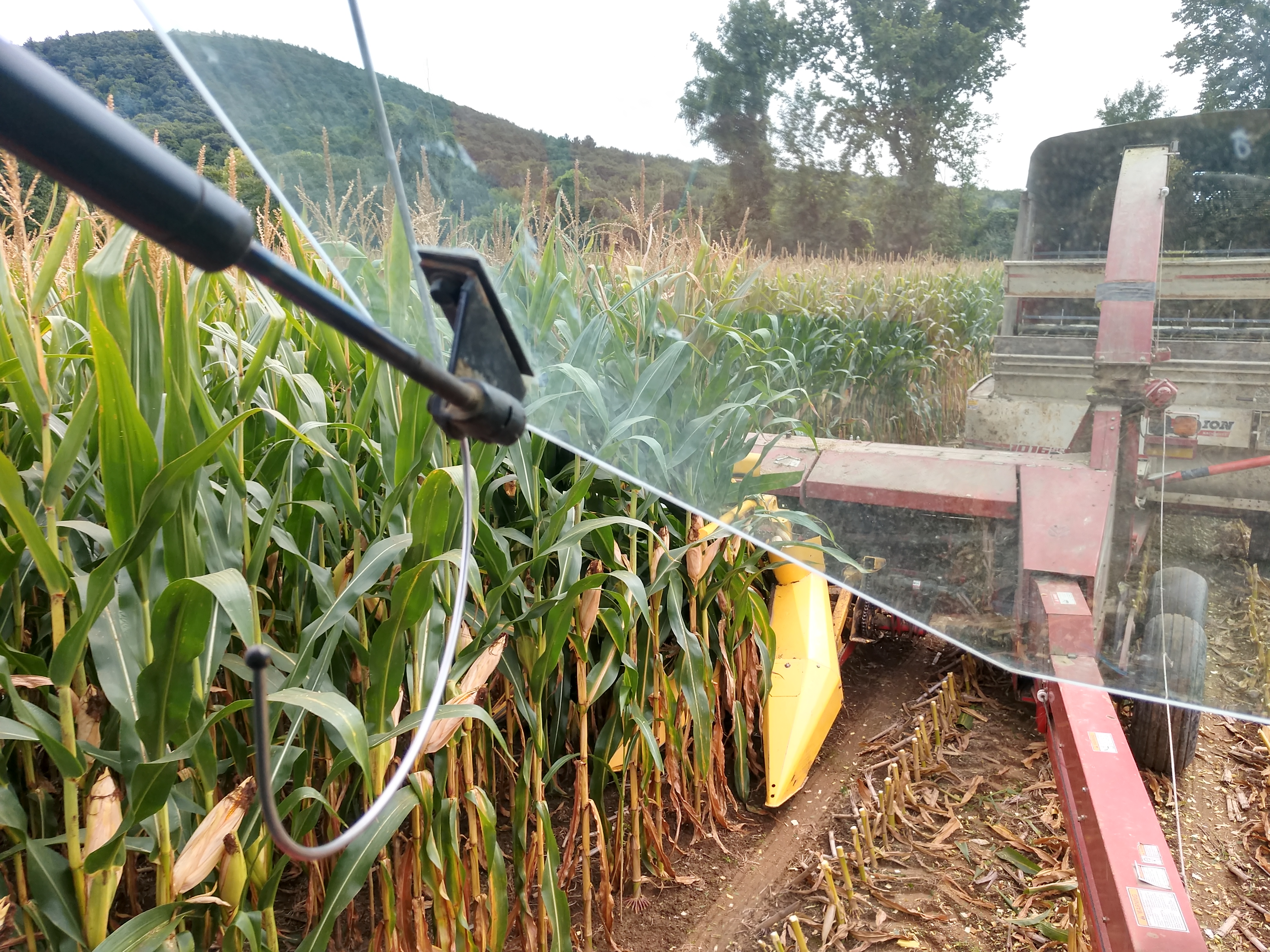

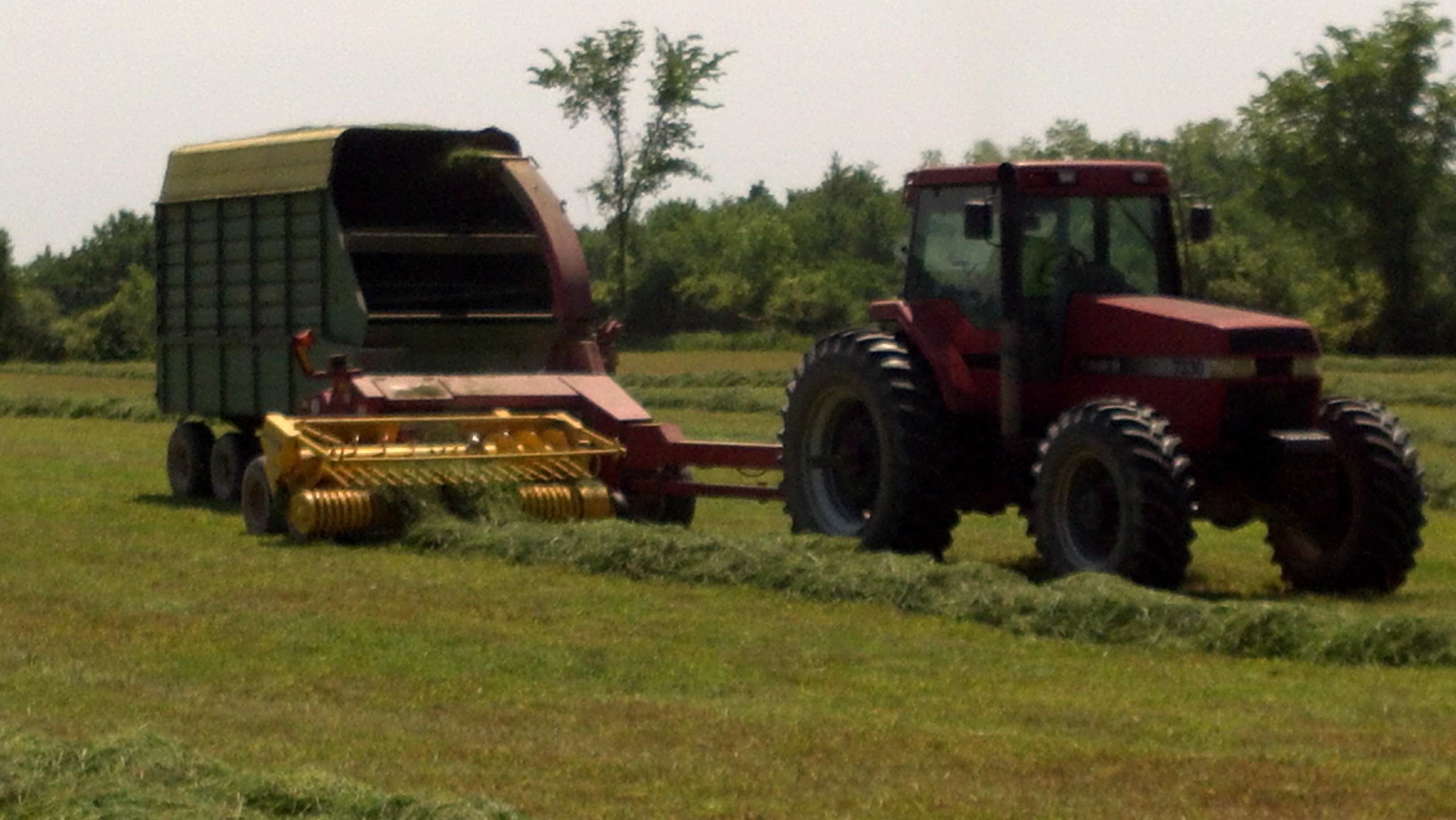

Of course then you can make it more difficult, start backing these up, 30 or 40 feet isn't to bad, a 100 or more or around a corner
gets to be a handle full and a study in aggravation :shocked:
