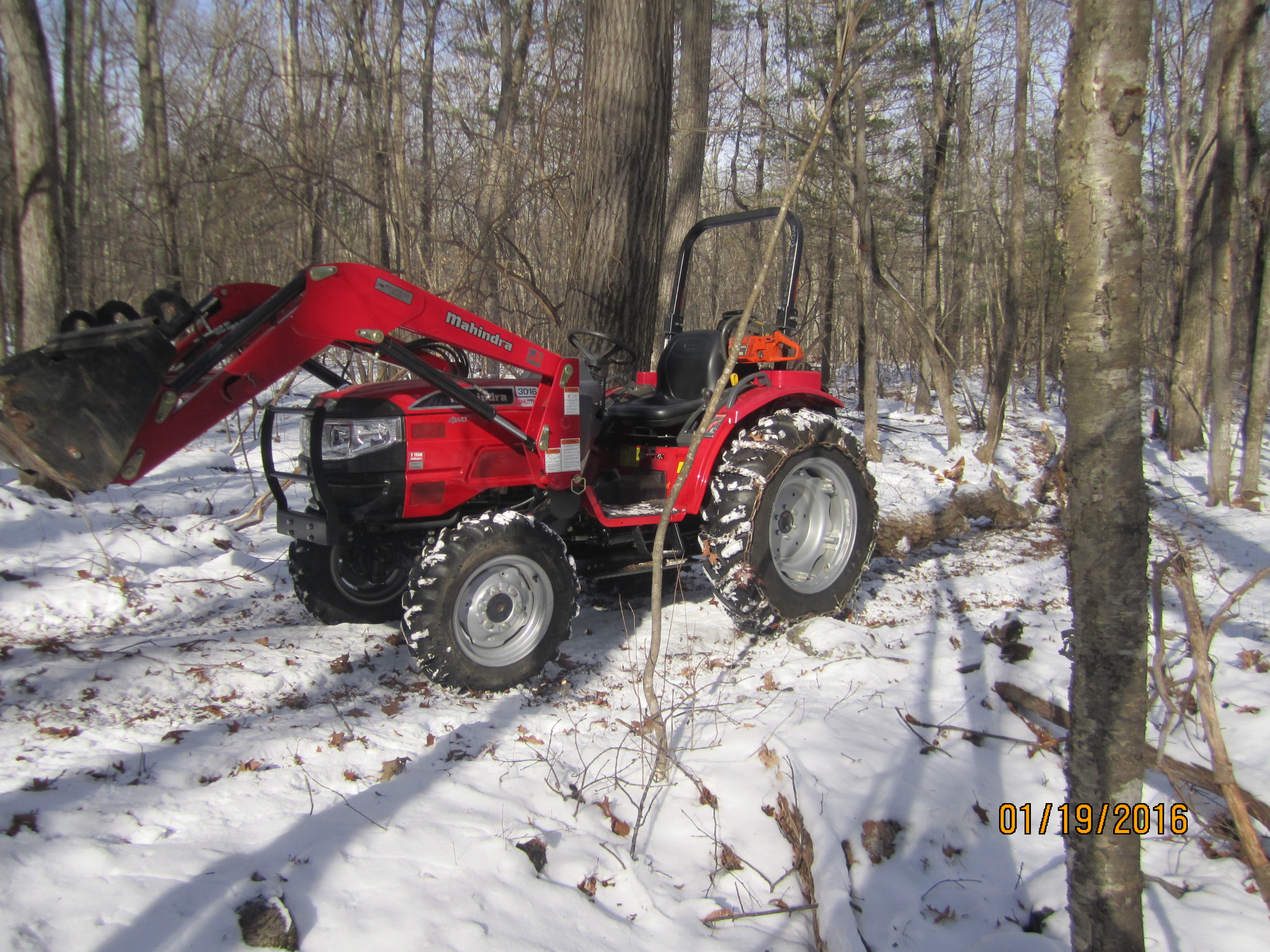

I have this tractor. I was going up hill with a stem attached and the thing just quit as if it ran out of fuel. With half a tank left, It wasn't that. I bled both the injectors and fuel filter area and this problem has not resurfaced. You may have an air entrainment somewhere. Sometimes it takes a while to clear. Tractor could be running perfectly fine then it happens again.
