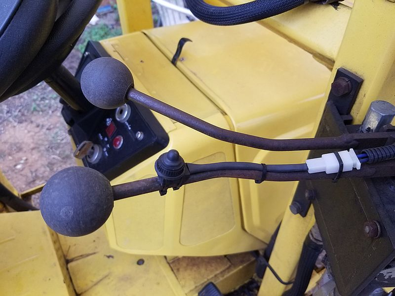

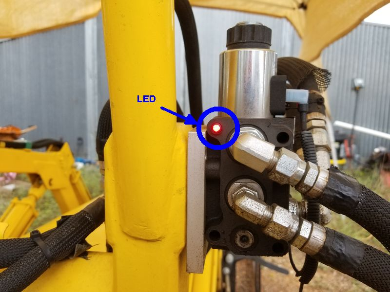

I've got a "diverter" on my Kenbota to operate the grapple jaw. I put a push-on/push-off button on the curl valve lever (2-lever system). To help me know which mode I'm in, I put an LED on the diverter to indicate "grapple mode". It's a small 12v LED and doesn't draw enough current to affect the solenoid function.
I'll try to get some photos later.
View attachment 773081View attachment 773082
That's weird: I could not see the pictures in your post. All I see is a bit of text at the bottom that says, "Diverter Valve.jpgDiverter Switch.jpg", like you tried to put in a picture, but failed. However, wen I hit reply, the pictures show up in my reply.
