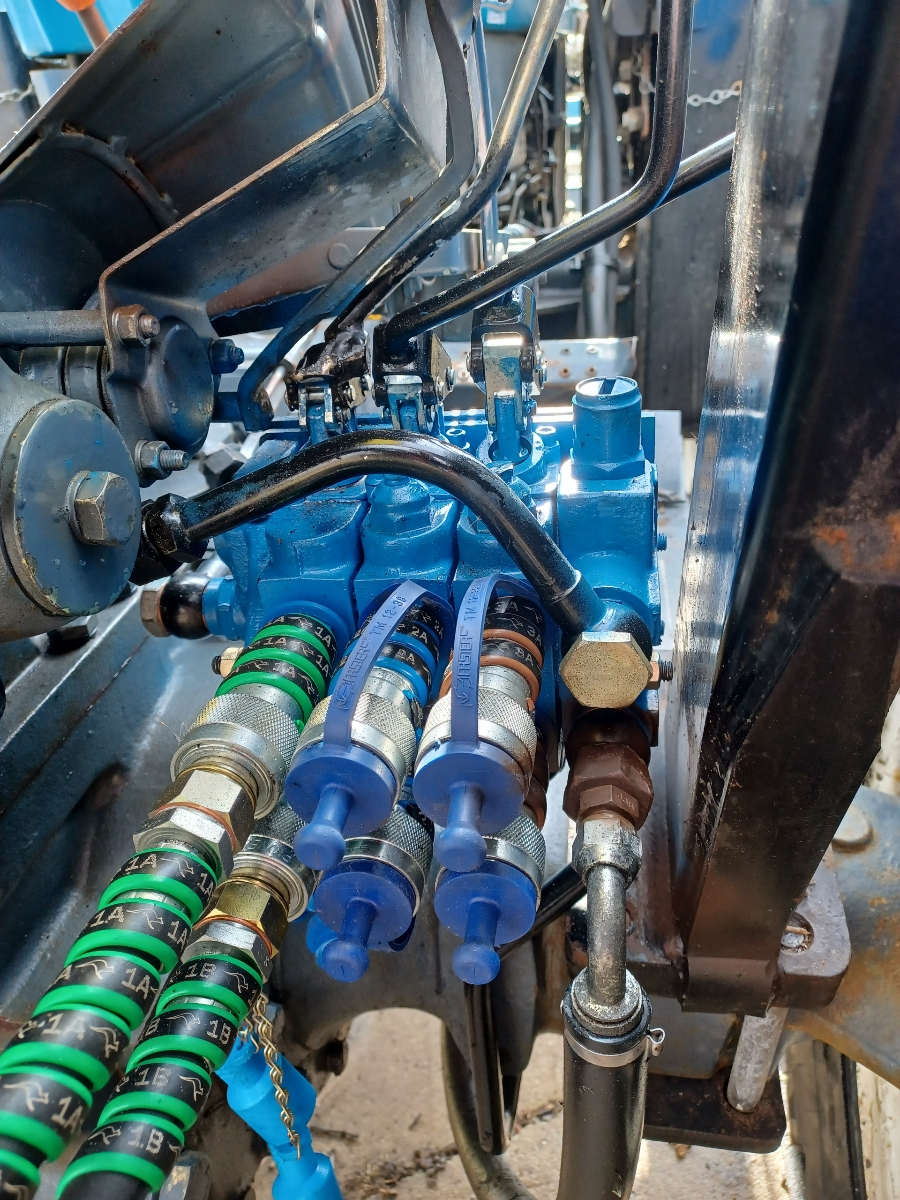

3010s new holland made in 1996 triple remote installation using TT60a dual remote bracket and tubing and oem valve sections. the 1st remote has float. i altered the factory tubing and levers as i saw fit

Nice job. Very professional looking. Thank you for sharing.

3010S ford new holland 1996 tractor triple remotes were easily added using a bracket and tubing from a dual remote kit for a TT60A New Holland tractor and modding the levers and tubing as needed. the 1st remote has float. I bought most of the parts from ebay and partspring. the knobs are for an Atlas
