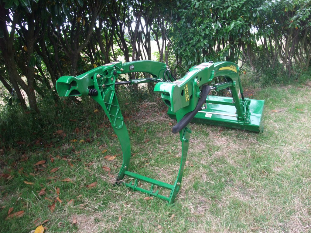

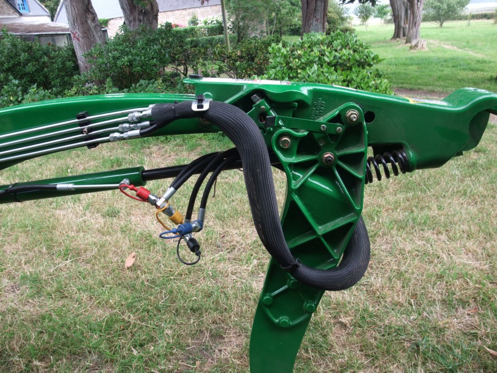

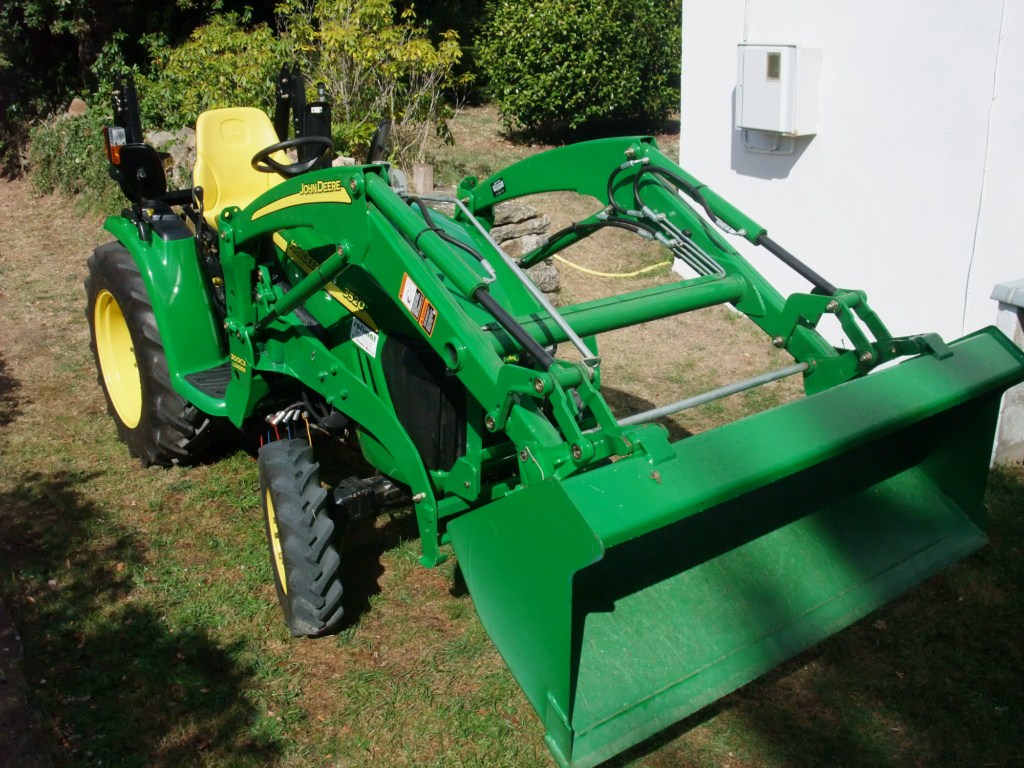

I don't know what you will find in the crate and how much of the assembly is left to you. What is sure is that the 300CX is not very heavy and you should be able to move the components for assembly without too much difficulty. And when you have assembled it and connected it to the tractor's hydraulic system, the loader will lift itself to come into place.
