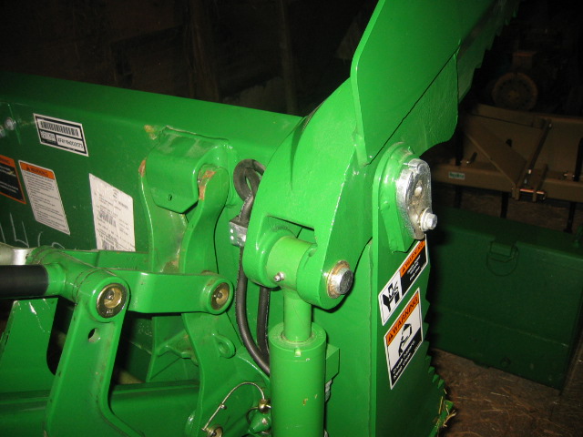

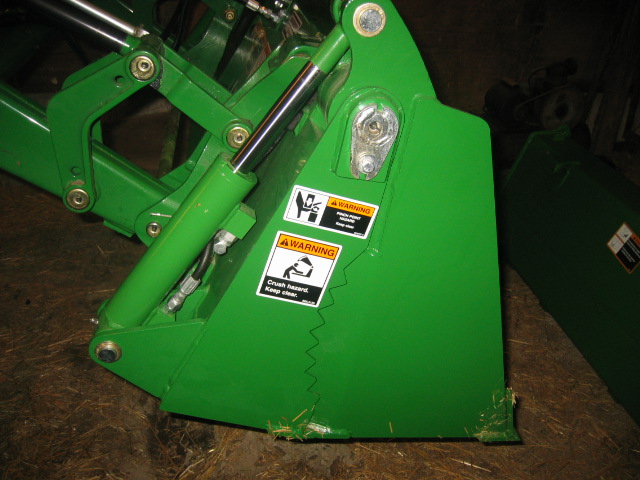

I have a 300CX on a 3320 and the 5' Deere 4in1. The only thing that would be better is a 4in1 on a skid steer. I have moved logs, brush, rocks and what ever else will fit in the bucket. If I am going to move a lot of dirt or rock I use my 5' bucket that came with the tractor because it holds a little more. I don't think you would be happy with a 6', 4in1 on a tractor of this size. I am carfull not to do things that would bend the edges but have found you the bucket to be very heavy duty and would not part with it.

Dan, the 5' 4in1 would be fine for my use. The skid steer units are nice but way too heavy for these tractors. I looked into a few aftermarket 4in1 and there either more than the frontier or way to heavy. I've got a grapple so most of my use would be with dirt work.I really want to be able to cleanly pickup the left over debris from raking. I wouldn't be using it as a dozer since the loaders just aren't built for that. Will your cx and 4in1 lift a heaped load of dirt to full height without issue? I'm curious to know how the 110 handles a 6' 4in1 heaped with dirt.
Yes, with no problem. The 4in1 won't hold as much as the stock 5' material bucket so if I am going bo be loading dirt or white rock I use the larger bucket. The only time I have ran out of lift with the 300cx is when using my forks. It won't pick up a full pallet of concrete blocks or a full pallet of shingles. It will pick up a concrete slab 4' spuare, 6"thick just to move it but I won't do that again.
Be carfull when the bucket is lifted all the way up. Things tend to come out over the back of the bucket like the piec of fire wood that fell out and hit my hood.
