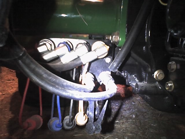

I was wondering if some people here can show me some picture of their (specific-ly) of there 3000 series CAB Tractor with the Optional 3rd funtion hydraulic couplers...
Reason I want to know, is because I'm still convinced my service manager doesn't know how the plate holding the couplers is supposed to be installed. I swear my 3rd function coupler bracket plate is upside down... because my loader hoses can't plug in to their couplers without interference from the 3rd function couplers...
The loader hose male head is supposed to plug in with the hose heading upward from the coupler, not downward...(so I don't get tire rubs)...
You should see how they have the hoses set up on this now... there must be 15 zip ties trying to hold the hoses back away from the right tire...
They were closed when I inspected the tractor out in their yard tonight...
Please somebody help me prove them wrong so I can print a picture and show him how it goes..

Jason, pages 45-7 and 45-8 of the 300 thru 300cx loader operators manual show the quick connects pointing up. Not sure how new this version is? Here's a pic from that manual, it shows the loader hoses and the 3rd function ports and hoses. I would get you some pics of my 3520/300cx but I won't have the loader back on until spring.
Sincerely, Dirt

Thanks for the pics.... Dan my plate looks totally different from yours... If I had my machine here I would take a picture of it... The way mine is set up, the curl in the loader hoses have to have a downward curve... instead of the upward curve like I think is the correct way of pluggin' so we don't get tire rub...

Jason, here is a pic of the 3rd function bracket on my 3520 cab. Is yours different than this one too? Don't pay any attention to the SCV hose fitting as they are on my 390 front blade and not the loader. I turn the blade fittings down.
Sincerely, Dirt

Thank you.... that was the winning photo that I needed! I appreciate it very much.

They should be up above the other 4 . That is the way it is on my unit. I also thing it was that way on my 4310.
