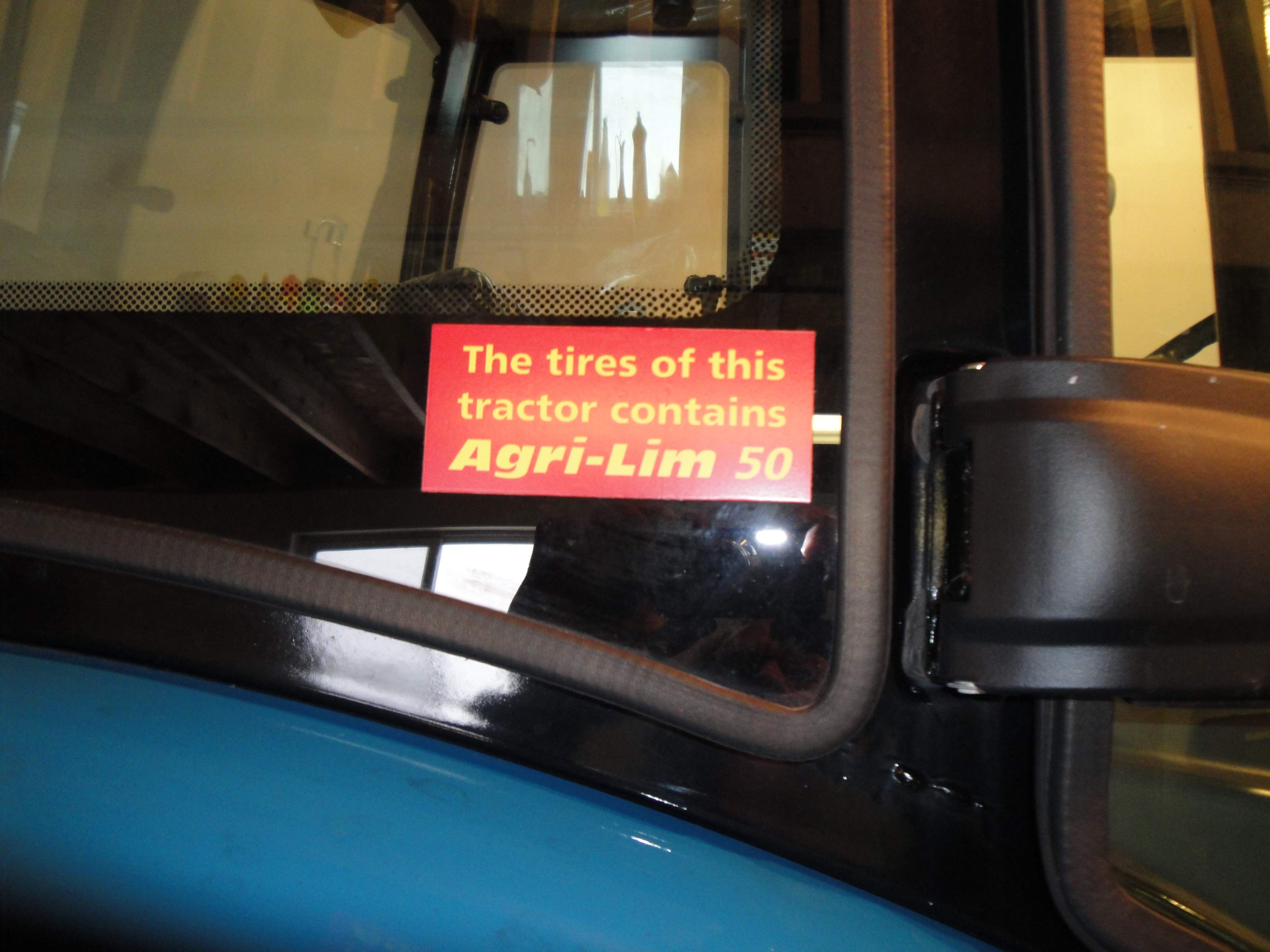

My LS dealer wanted $600.00 . I ended up getting a tire company come to my place to fill the tires. Ended up being around $750.00. Expensive but at least its done.

Darned overpriced tractor dealers!:confused3:
It looks like the tire company is the one who was really over priced!
   / $300 to load rear tires #38
And you could have financed the $600 as part of your purchase.
