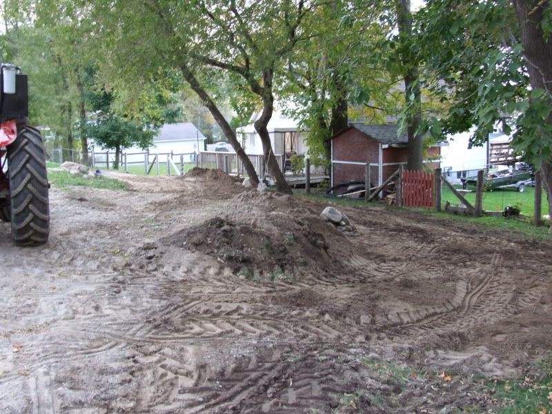

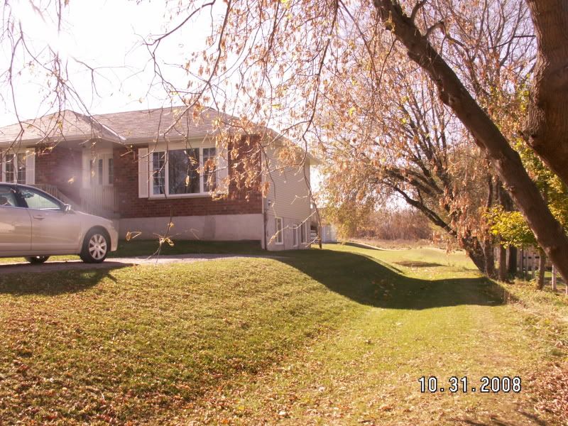

I purchased my home last Dec. It has a great shop but no driveway out to it.
The main tool.
I dug a trench and put in electrical, cold water and a weeping system to control spring flood waters.
Before work began
building the on ramp down to the yard from main driveway
Brought in boulders from nearby fields to support the sides of the ramp

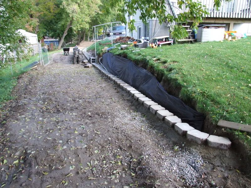

Midway through my retaining wall along side of the house

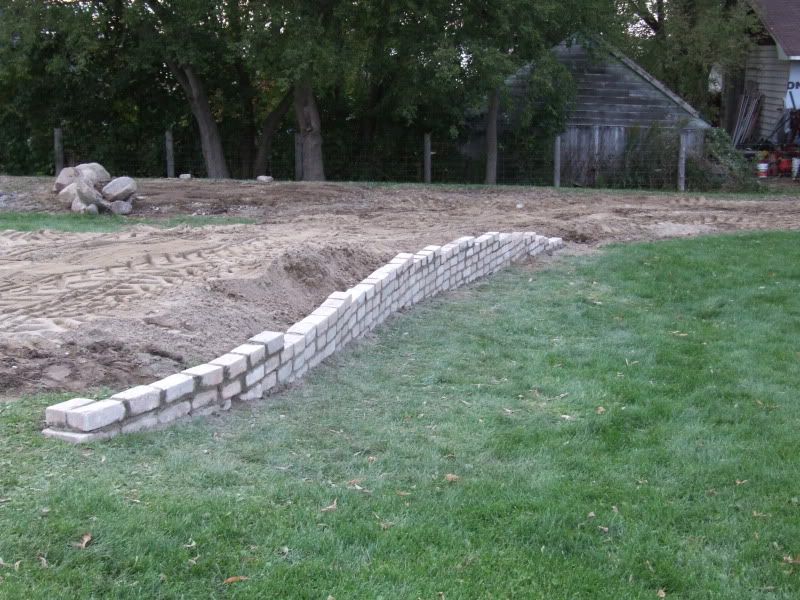

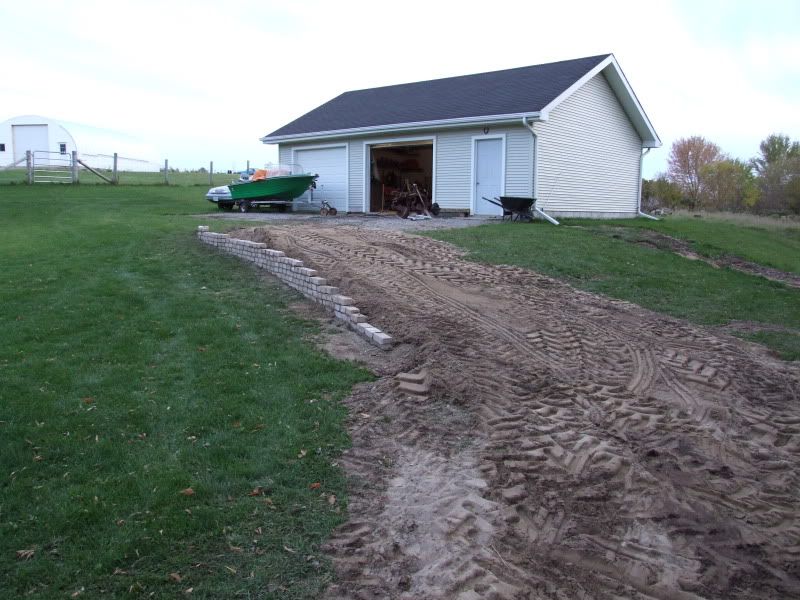

and a small retaining wall out by shop to support the ramp up to the garage, I used small bricks because they were free
I will try to keep this post going to the finish, brought in two triaxle truck loads of limestone screening today, and got remainder of retaining wall stone, just need to put in some more labour.

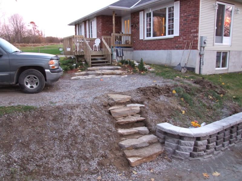

Well I have been steadily plugging away in any spare time I have. It is dark by 5:30 now, so not much gets done between my job and sparse weekends. But I now have a good enough base to drive on for the winter.
Also if you notice in my before picture, there is no sliding door, I put one in so now I have a great view.
Retaining wall is in, and I am part ways done putting in a little granite stairway
Not sure if I will do much more until spring. I may let things settle over the winter/spring thaw and see what kind of movement I get, if any, knock on wood.

How did you smooth out the gravel?

Yeah, odd someone would build a lakeview house and not add the lakeview, but fixed now, and as for there being a floor under the sliding door, that is merely an optical illusion, there is 12 inch floor joists in between the upper and lower. The smoothing was a painfully slow process between my 6 foot blade, hand raking and a ride on pavement roller which I borrowed from a friend.
