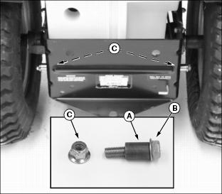

I am I terested in buying a used 30" tiller for my 345. I found one available. The current owner said that it came with her 345 that she bought used 8 years ago.
So, the attachment kit must still be on her tractor. If I buy the tiller from her, I'll need to know what parts need to be removed from her tractor and what tools I'll need to bring with me.
Anyone have this setup and can send some photos? Do you like this rototiller? Is it worth $350?
Thanks,
Mark

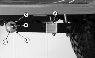

Found this in the online manual.
Is it really just the 4 pins?
"Install Tractor Rear-Frame Hardware
M96287 M96276 1. From bag of parts, install one spacer (A) on each M12 x 1.75 x 50 mm flange bolt (B). 2. Install spacers and bolts in BOTTOM holes at rear of tractor frame and secure with M12 x 1.75 locknuts (C) on inside of tractor frame. Tighten locknuts to 105 N·m (78 ft-lb). Install Tractor Mid-Frame Mounting Pins
IMPORTANT: Avoid damage! If spacer (E) falls out of draft arm (A) when pivot bolt (D) is removed, return spacer to its original position inside the draft arm hole. Damage may occur if spacer is missing or improperly installed.
M96288 1. Locate draft arms (A) under left and right tractor foot rests. Remove locknut (B), washer (C), and pivot bolt (D) from each side. Discard original pivot bolts."
