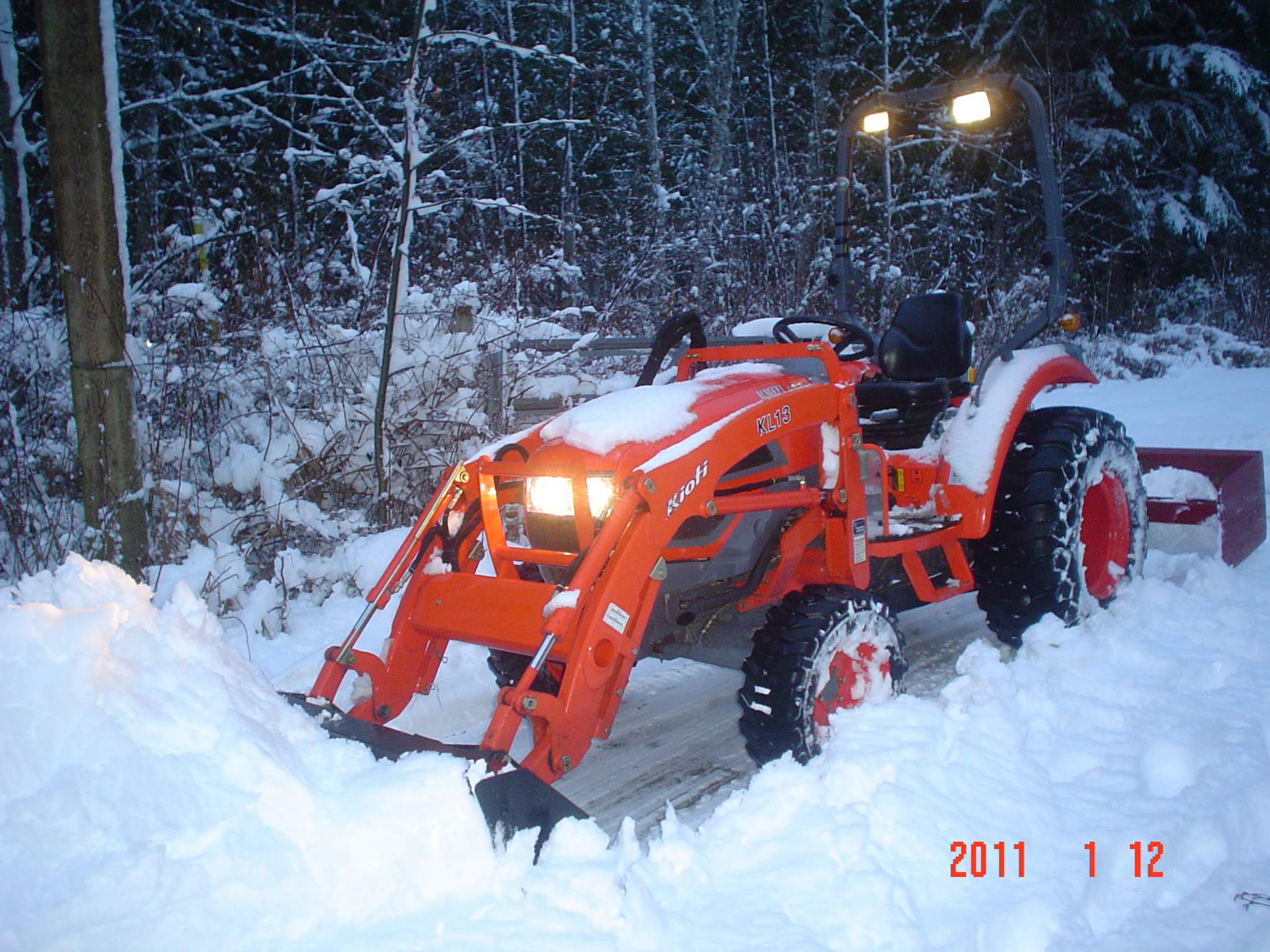

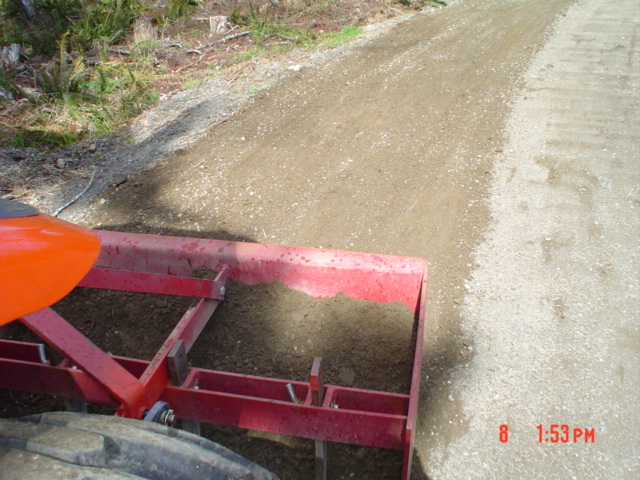

I have a Kioti CK35 HST. It is all the size I need for my mostly wooded 14 acres. 51 HP just seems huge for 10 acres. :)
