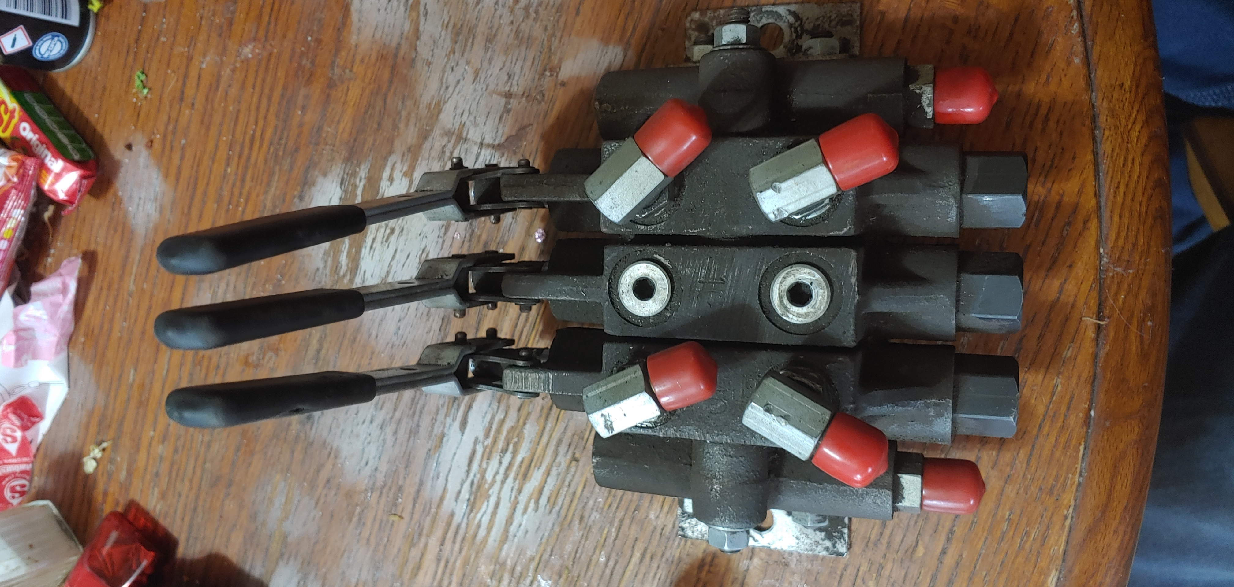

Neighbor let me grab this from his garage. Said it wont work on his jd tractor. Anyone know if it will work on my ford 1900 with live hydraulics. I dont want to try and hook it up if it will mess up or damage anything. He said he was told it would dead head his system so not sure if it will do the same on mine.

Josh,
Is there a name plate or model code on that valve assembly. From the picture I cannot tell if there is an option for power beyond or not. Are there any unused plugged ports on the ends?

No relief valve nor PB ability, so it can indeed cause serious problems if plumbed wrong.
For that valve to work well and with not risk, it would have to be the very last valve on the circuit. But on these tractors, the 3PT valve is usually the last and the plumbing is all done internally, so it's not possible to make any change.
