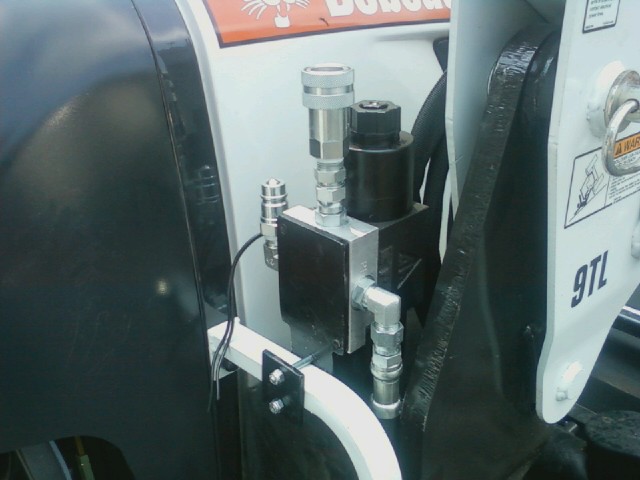

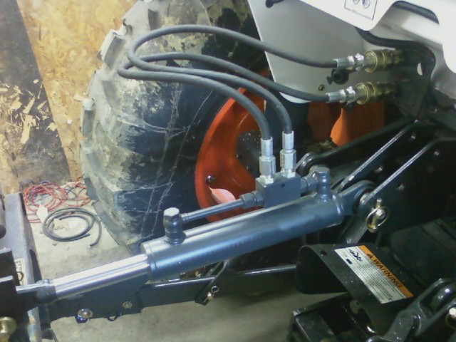

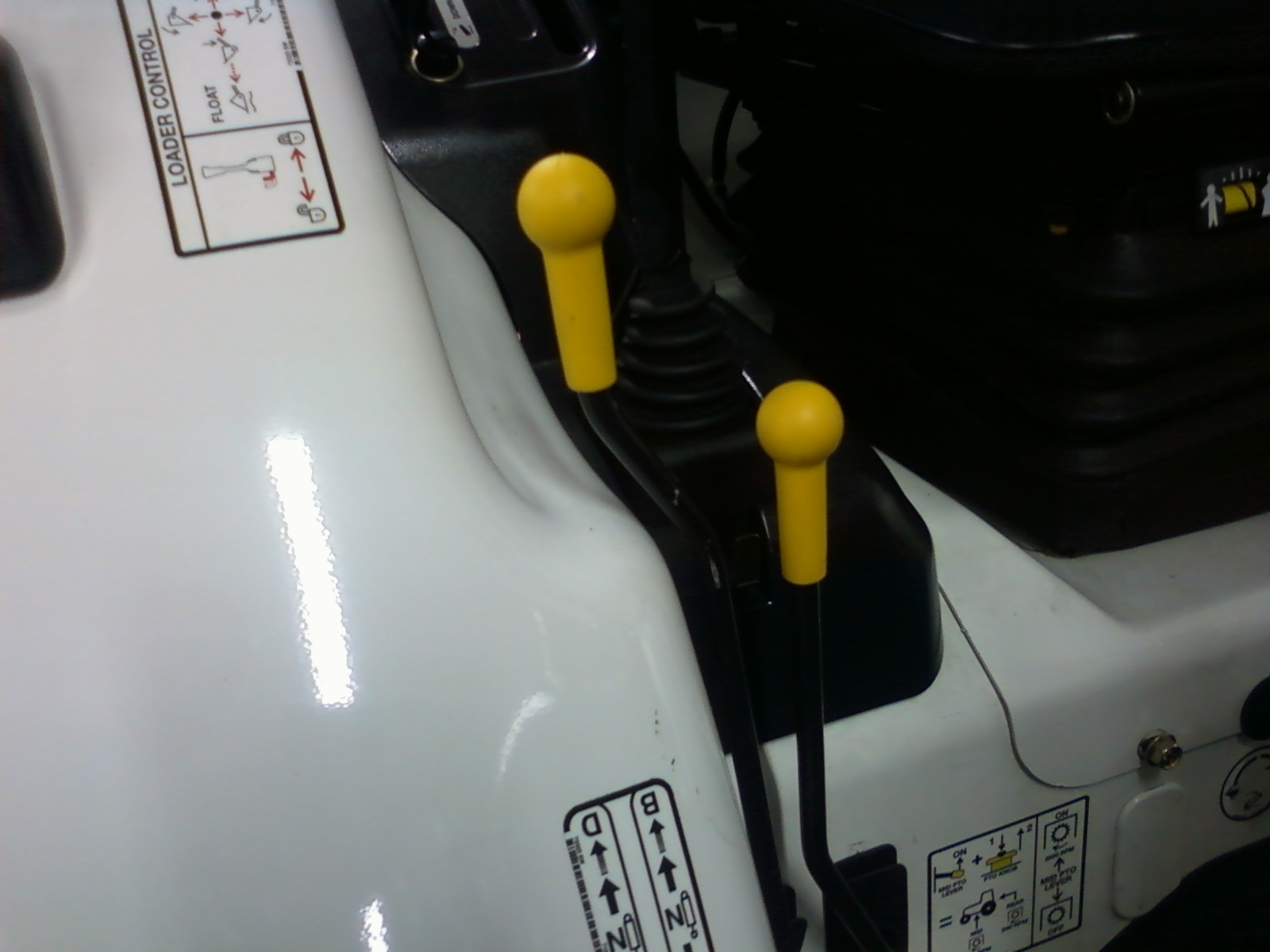

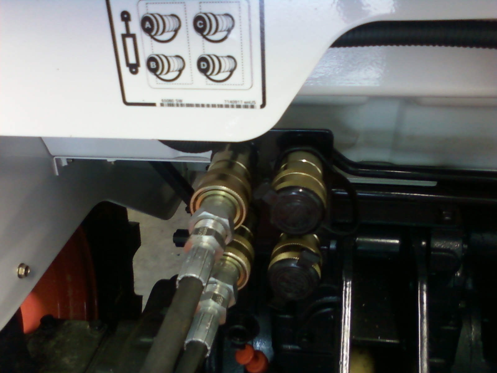

I finally got around to installing my remotes, 2 rear and a 3rd function front remote. I installed 2 Bobcat remotes one with detent and one without. The front is a WR Long kit for my grapple or anything else I want to run out front. The WR Long kit is nice got it from Wallace Tractor ofcourse, it comes with everything you need including a new handle with rocker switch for front hydro control while still maintaining full loader functions.

Nice toplink! Did you have any trouble installing front aux. remotes? Wondering how much did the kit cost, I really would like to install a grapple on my CT450.
   / 3 remotes installed
The front was super easy to be honest about an hour or so to install. You have to take the seat off, remove 1 hard line off loader valve and replace with new hoes provided, mount valve 2 bolts, tighten up hoses, wire 3 easy wires and replace joystock handle.
I will take some other pics with grapple on and in use.
As far as price I purchased everything at one time when I got new tractor, call Rick at wallace tractor for a good price.

When I installed my dual rear remotes on my 335, I was told that detented ones were discontinued and that I would have to use a bugee cord or something to hold it open:confused:
My rear remote spools were sent from the factory in the open position, but there was a detent kit that came with them but it needed to be installed, so I chose the C-D remote to install it for my back hoe, so now I have one of each. So the kit must be still available for installation, maybe the only ship the valves with no detent, prob to protect people from leaving them on and burning up the pump.
