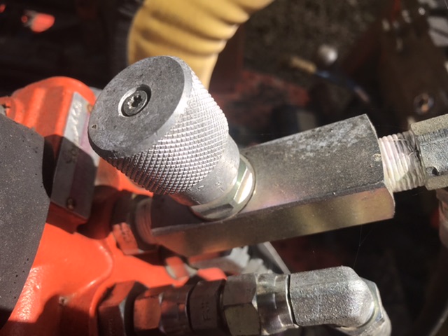

Often implement cylinders are much smaller than a loader cylinder. Because it holds less volume of fluid, the drift will be much faster.
After 7 valves with no improvement maybe you should consider flow reducing valve. You could install at the cylinder you are having issues with and screw it all the way down for roading. The cylinder will hold forever with no external leaks. Then you could adjust the speed of operation when you get to where you need to use the implement.
This is what I put on my Kioti remote valve although for a different reason.
   / 3 rd function issue and Gannon box hydraulics #9
Diameter wise my TnT cylinders are the same size. They are a lot shorter though. Percentage wise an inch on each is different, but will be around the same volume of fluid leakage. But 6-7" or more of travel on the tilt cylinder in an hour is pretty unacceptable. The loader cylinders dont move an inch in weeks.
After all the valves, I've kind of given up on getting Kubota to fix it under warranty. My best valve is #1 & on my toplink. It only leaks down an inch, maybe 2 per hour. I use float heavily on the toplink. It's in float whenever mowing, hitching or unhitching stuff on the QH & sometimes when grading with the LPGS or box blade. I'd be lost without it. Less reliant on float on my tilt cylinder.
Thought about getting a DPOV on my tilt cylinder, which breaks float. Or possibly putting a solenoid valve on the rod end to lock it in place as needed despite the leaky valve but still leave me the option for float when needed. Other projects are higher on my list for time & budget at the moment though.
   / 3 rd function issue and Gannon box hydraulics #10
That makes sense. I did use DPOV on both my tilt cylinders. I was thinking you had pull type implement leaking down. That is why I suggested the flow valve.
