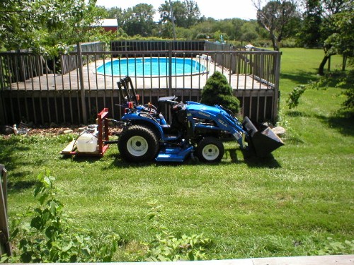

Jerry,
I know this is not a 3 pt sprayer, but it works for me since I just need to do occasional spot spraying. Sprayed about 25 gallons of Round-Up concentrate today in a couple of hours. I got a 25 gallon sprayer from Agri-Supply and set it on the carry all.

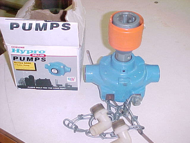

The 3ph sprayer I have is a 55gal model with a 10' boom and 7 nozzles. Mine is not from TSC, but it sounds like it could be similar to yours.
The roller pump did come from TSC, however. I relied on their suggestions. They steered me to a Hypro series 6500 (pictured) cast iron roller pump: 9.7 gpm @ 540 rpm. It's been put to use 3 times a year for 3 years now, and seems to work very well. I have no complaints.
Cast iron pumps do require a bit of post-spraying maintenance or they can freeze up with rust (First hand experience is a good teacher /forums/images/graemlins/blush.gif). After spraying, I flush the whole system with clean water. Once the pump is removed (do it right away...don't let it just sit on the tractor /forums/images/graemlins/blush.gif /forums/images/graemlins/blush.gif), it gets a healthy dose of WD40 in the inlet/outlet openings. Then, I let it dry for a day or two before sealing up the openings with the plastic plugs that come with the pump. Every once in a while, throughout the year, I will give the PTO connector a spin by hand just to make sure rust hasn't caused it to bind up. I don't know if my maintenance routine is proper or not, but so far so good.
Sorry, I can't remember what it cost.

OkieG, you mentioned '9.7 gpm @ 540 rpm'. Do I have to run at pto speed? If I am happy with 5 gpm, can I run at a lower engine speed?
   / 3 pt Sprayer Advice #8
Jerry, I'll answer for OkieG /forums/images/graemlins/laugh.gif. Yes, you can run it slower and I frequently did. You'll be running at lower pressure and I'm not sure how much difference it'll make in volume dispensed.
   / 3 pt Sprayer Advice #9
Thanks Bird! /forums/images/graemlins/grin.gif
<font color="blue"> can I run at a lower engine speed </font> I do all the time. The technique for calculating fluid volume dispensed for a given lawn area versus a constant ground speed doesn't work well for me. My yard is too lumpy and it's hard to keep a constant ground speed.
I put the right amount of chemical for my sized yard in the tank along with enough water to mostly fill the tank. Then I spray at less than 540 rpm and expect to spray 2 or 3 passes to empty the tank.
By the way, if your sprayer can't use all the flow the pump is putting out, the excess bypasses the spray nozzles (at the valve) and is returned to the tank...no problem.
