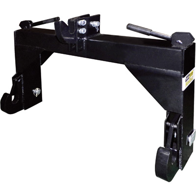

I have been looking at the quick connect for the 3 point hitch for my 8N.
Anyone used one on a similar tractor? Does it work as easy as it looks?
I was looking at the one from Northern Tool.
NorTrac Three-Point Quick Hitch Category 1 | 3-Point Hitch Adapters| Northern Tool + Equipment

NO they dont work as easy as they look.
For starters, what implements do you have???
Just guessing, but most people I know with old ford tractors, also have old implements. The lower pin spacing has to be EXACT of that quick-hitch wont work. And also just important is the location of the toplink on the implement. Since the QH is rigid, ALL of the toplink holes on your implements have to be in the SAME location, and usually set forward a bit so you can "hook" into it from under.
This one is QH compatable. King Kutter's 84" Professional Quat Rear Blade Notice it is open below the toplink hole so you can "hook" it up from under.
This one is NOT Everything Attachments 5' Value Scrape Blade for Compact Tractors with 25-50 HP Notice it is NOT open below the TL hole.
Now, if you understand all of that, check your implements. IF you do have ones that ARE compatible, they are okay. But also keep in mind that they place the implement farther back as well. And the 8n doesnt have super strong hydraulics, or alot of weight up front. And also may require a longer PTO shaft on your equipment as well.
If your implements are NOT compatible, they make JUST lower links that are quick attach. PAts easy-change, or carter.

ditto what ld said.
if everything is exact.. it works.. :) if it ain't exact.. you have to modify it or it don't work. it also sets the implements back, menaing you might have pto shaft length issues as well.
