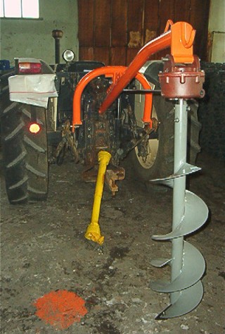

The Leinbach PHD is a very sturdy unit and very cost efficent. You may want to look into one of those. E-mail me for a picture of the unit that would work on your tractor. Also they make a compact version that is a lot easier to hook up and it allows you not drag the auger on the ground.
   / 3 Pt post hole digger #4
Leinbach PHD picture
   / 3 Pt post hole digger #6
I have one, so far it works great but I have pretty loose/sandy soil. What I also like about the design is that it serves a dual purpose. You remove one pin at the gearbox and you have a utility boom. I keep mine disassembled like this as it is easier to assemble by myself. Put the yoke and boom on the tractor and then back up to the rack in my barn where the gearbox/auger is kept and attach the gearbox to the boom.
