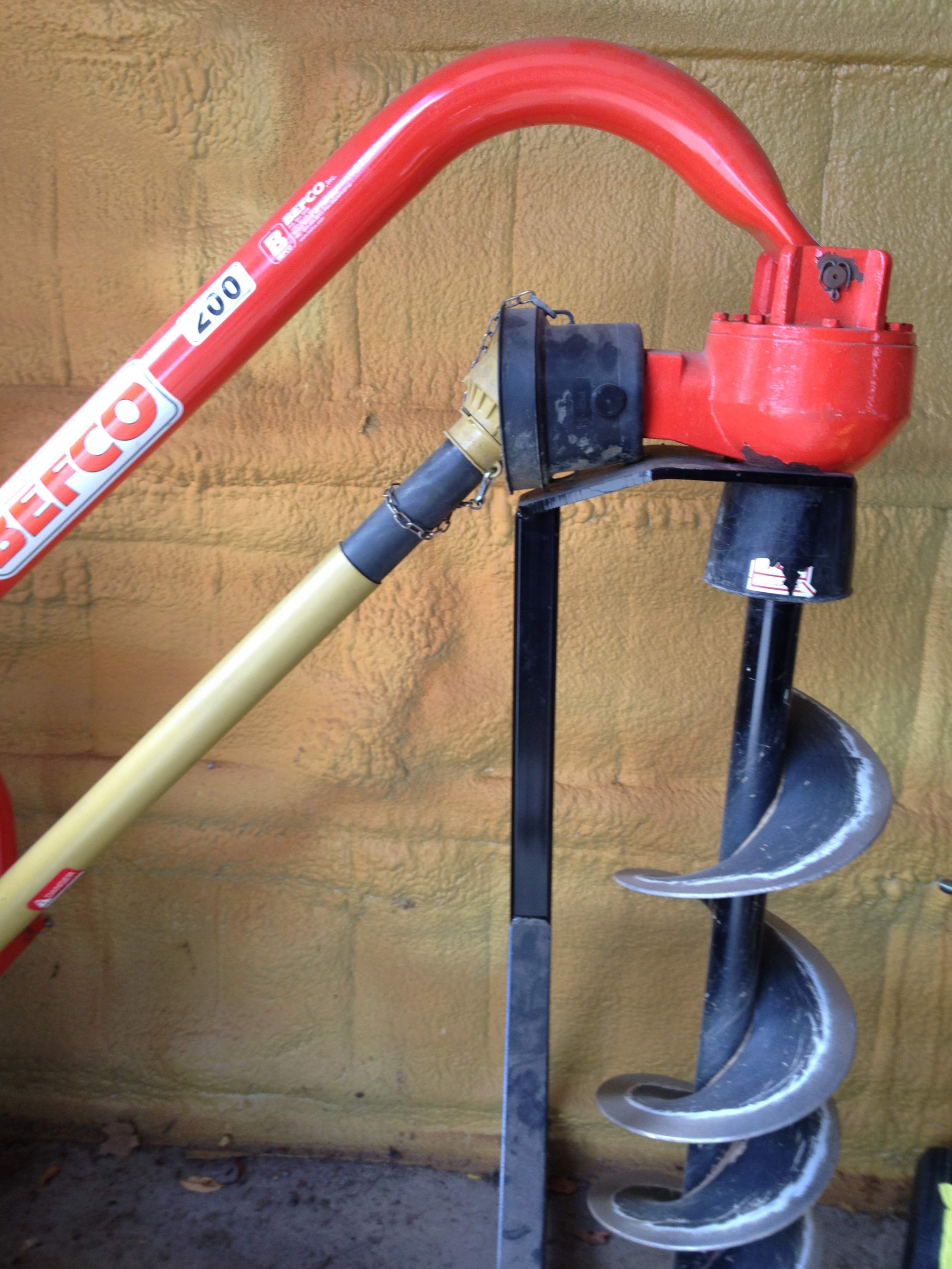

I have a befco post hole digger that has served me well.I would also check out Danuser & woods diggers also.I am not a big fan of the TSC county line equipment.
