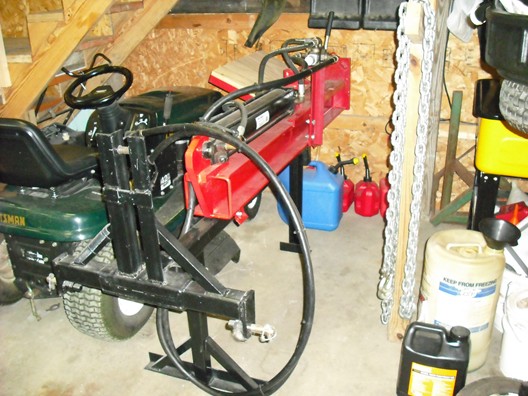

I built my own splitter because I could not find what I wanted and have no problem running it with my Jinma 254/284. It has plenty of power and will split anything I can throw at it at only 1,200 rpm or so on the tractor.
Chris

Diamondpilot,
What is the gpm and psi your Jinma is operating at?
   / 3 pt Log Splitter: PTI. Hydraulic or stand alone?? #10
I know its 2400 PSI because I added a gauge on the output side of my pump. I am not so sure about the flow but I think its 5. I will try to look for ya.
Chris
