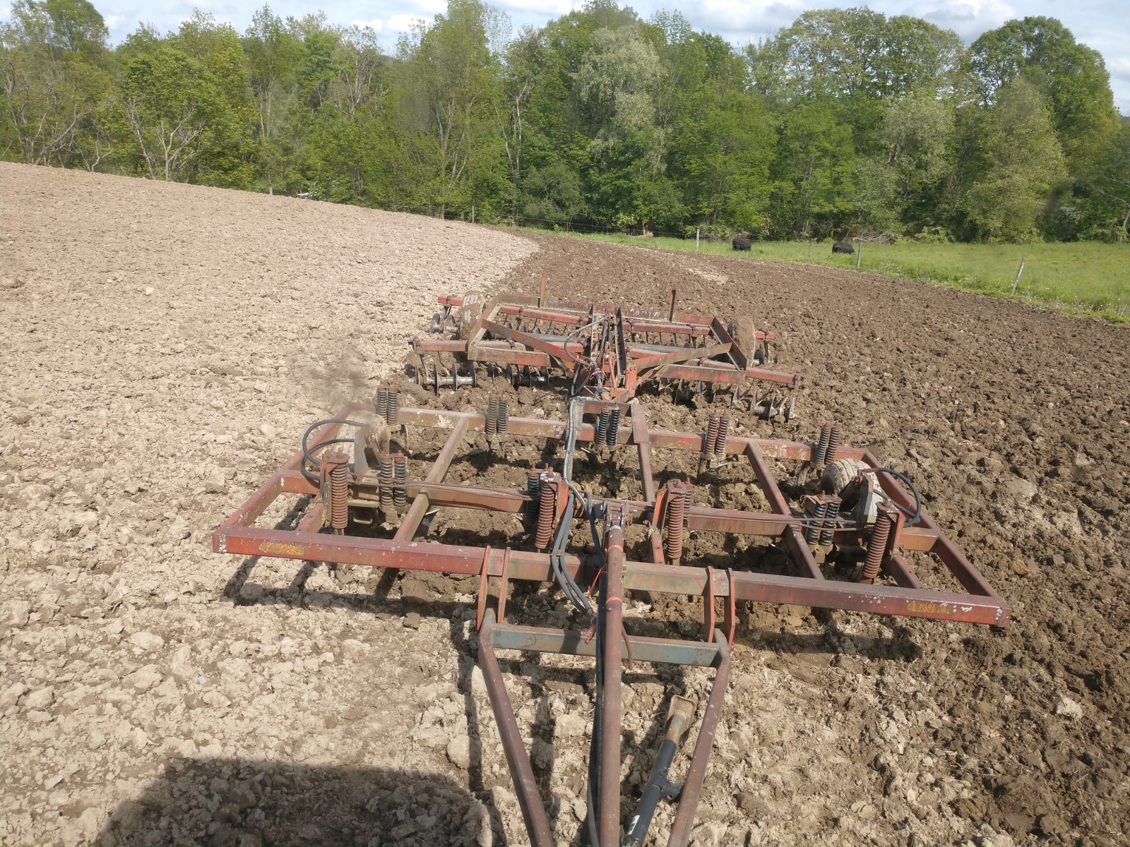

I'll have to disagree with you on that statement, apparently you have never worked with drawbar tillage implements.
It is hard to see in this picture but draw bar discs have an adjustable hitch height and I guarantee that you can get tractor loading from them.
You pop off with lots of knowledge sounding information which at times is incorrect.
As does the drawbar pulled chisel plows the hitch is adjustable to get your tillage implement level so it will work correctly, the angle of attack on a set of tandem disc is to set how aggressively you wish to have them stirring up the soil, the weight that can be added to a set of disc is to increase the depth of penetration.
That weight can be evenly distributed or biased to the front and the hitch adjusted to pull them level.
