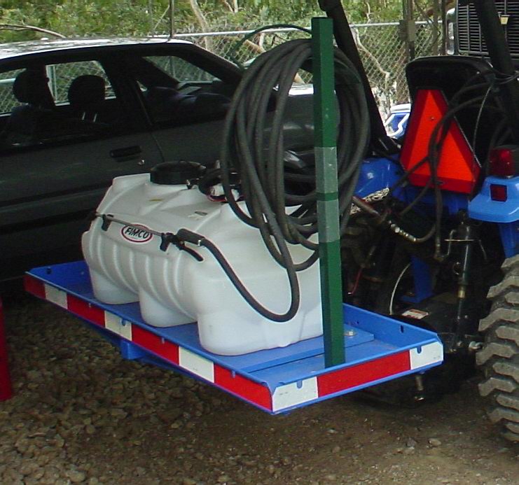

Here is a 25-gallon Fimco 12 volt sprayer with 50 feet of hose. It is mounted on a cheap 2-inch receiver hitch carrier and with the use of the Three Rivers 3 point hitch adaptor I was able to get myself an ok sprayer rig. It works well but the Fimco sprayer does feel like it will not last very long. But the price was right! /forums/images/graemlins/cool.gif
