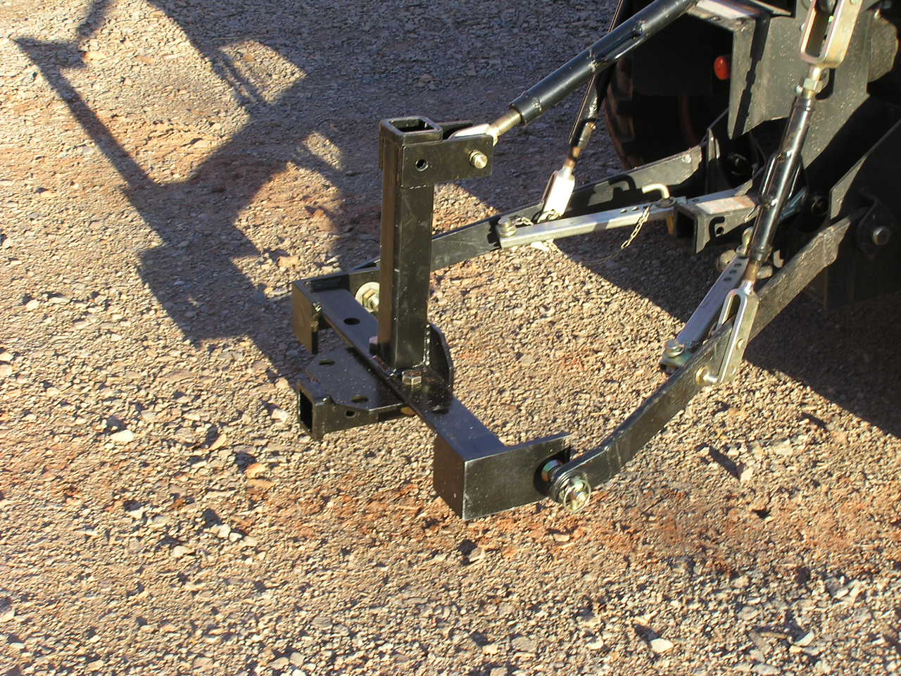

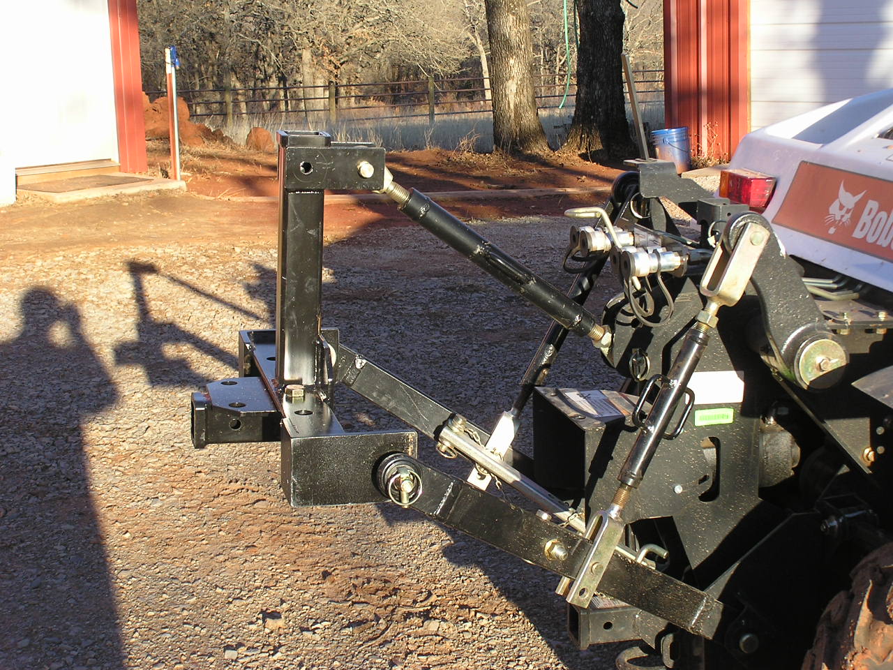

Option 1 should work, but I have no experience with Yanmar tractors.
Option 2 sounds like the way mine is made. It was in the lower hole and I put it in the upper hole for more lift height.

Thank you. The photo is very reassuring. I'll go ahead and drill a 2nd hole about an inch above the 1st hole.

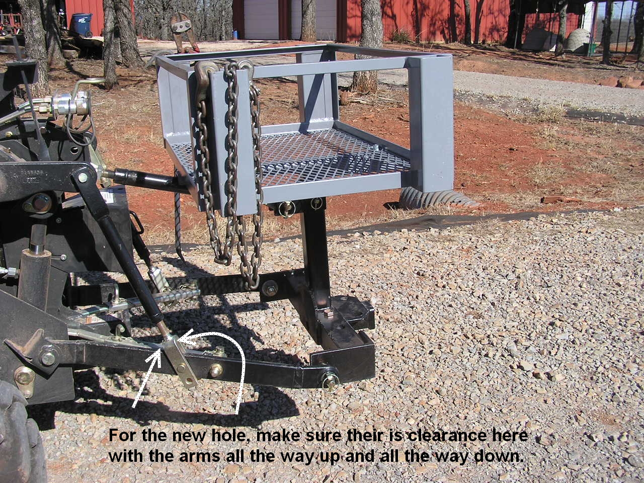

Check for clearance as noted on the picture, to get the hole in the right place. The link will bend if the new hole is too high.
You can grind some small grooves if needed.

Xfaxman - Thankyou for your advice and photo. I think my one inch is do-able with a small margin to spare but I'll certainly tripple check by raising and lowering the link and measuring the clearance between the U of the fork and the lower link edge before I commit to drilling.
