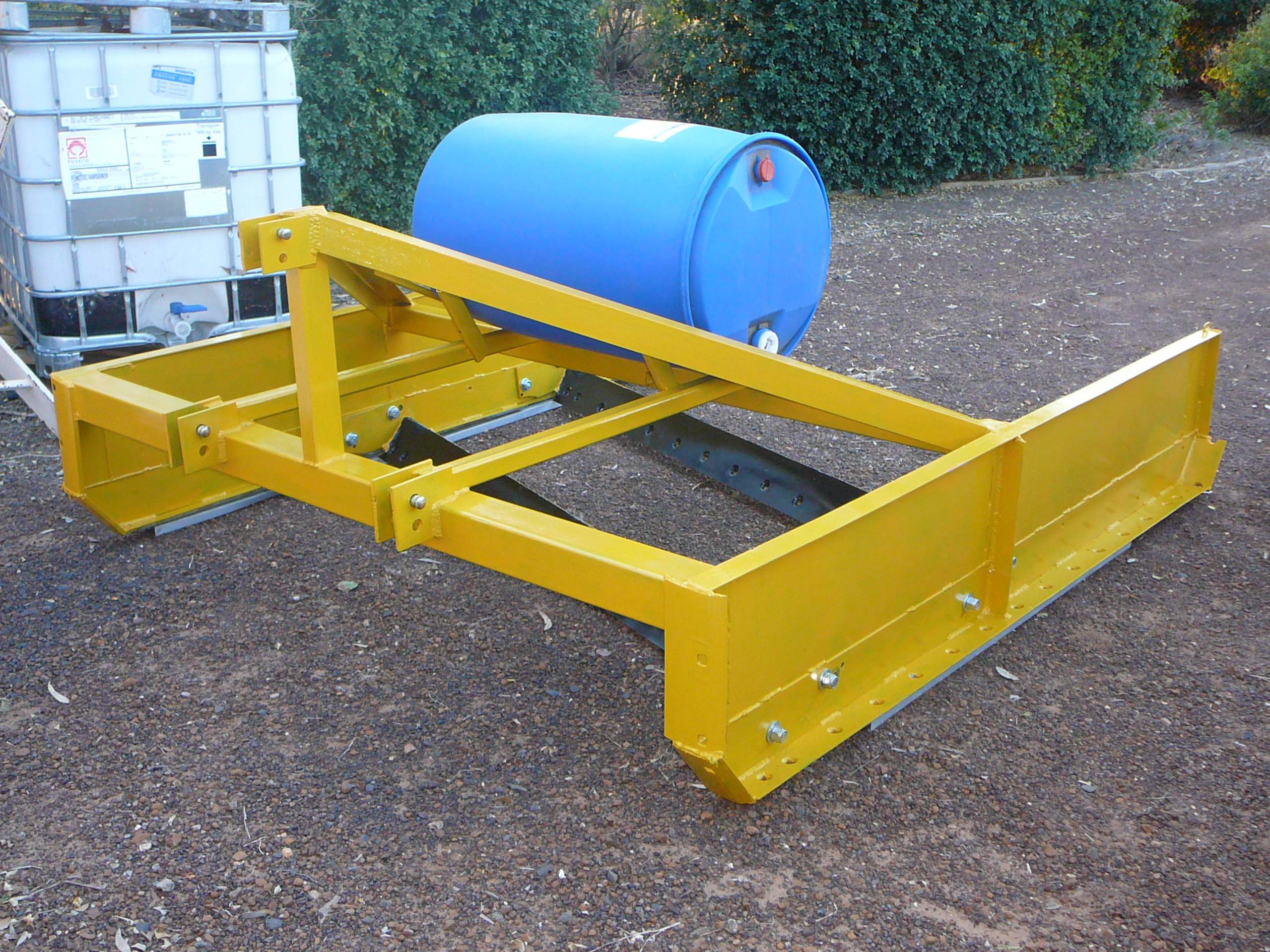

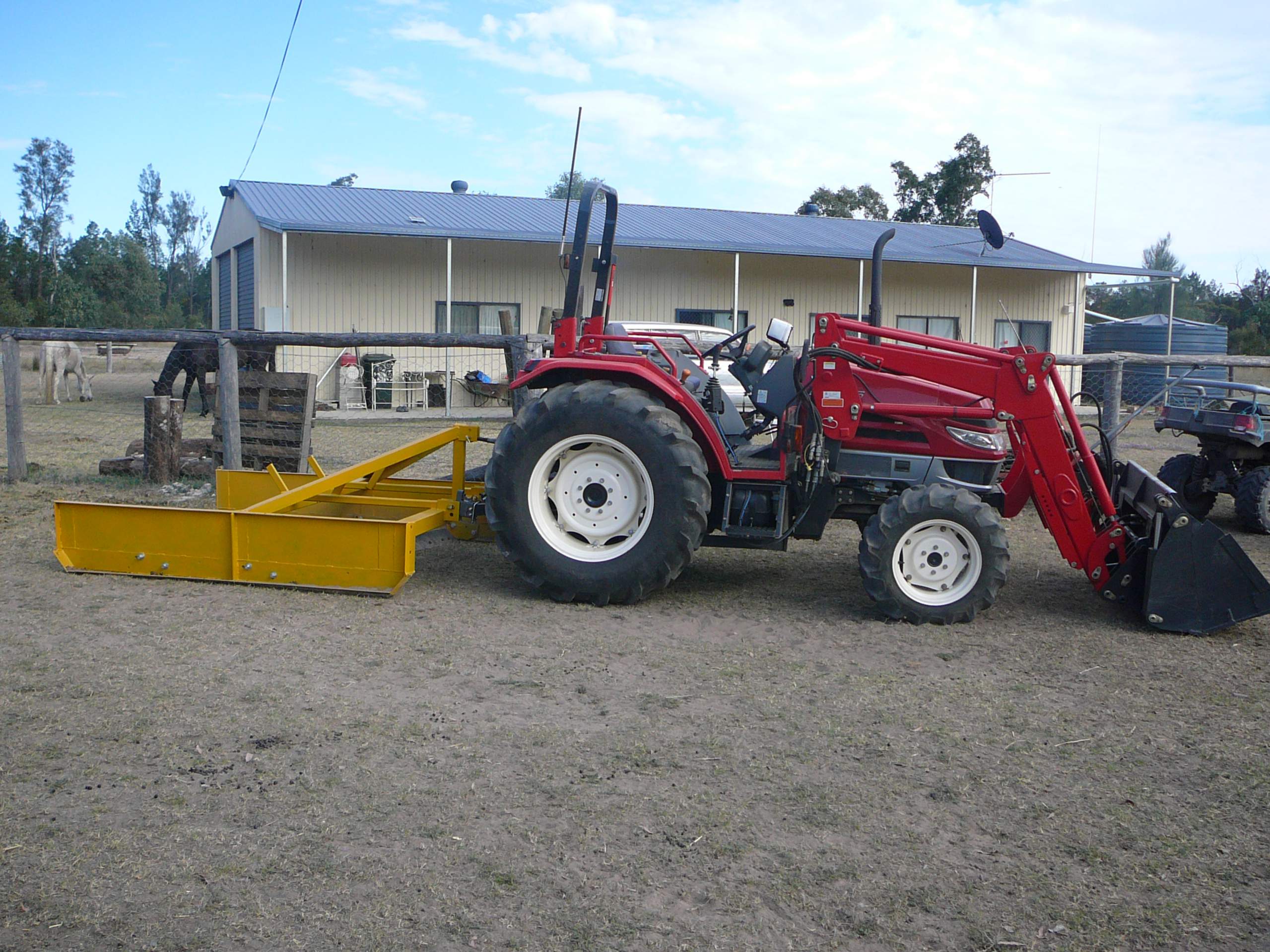

A land plain is much easier to use and gives better results in most cases if you just want to level ground.
A floting top link on your box blade I think will just make your box blade lift up at the back. I was going to do that with my land plain which is 8' long and a lot heavier than a box blade and it still lifted the back.
http://www.tractorbynet.com/forums/build-yourself/287452-land-plain-blade-height-help.html
