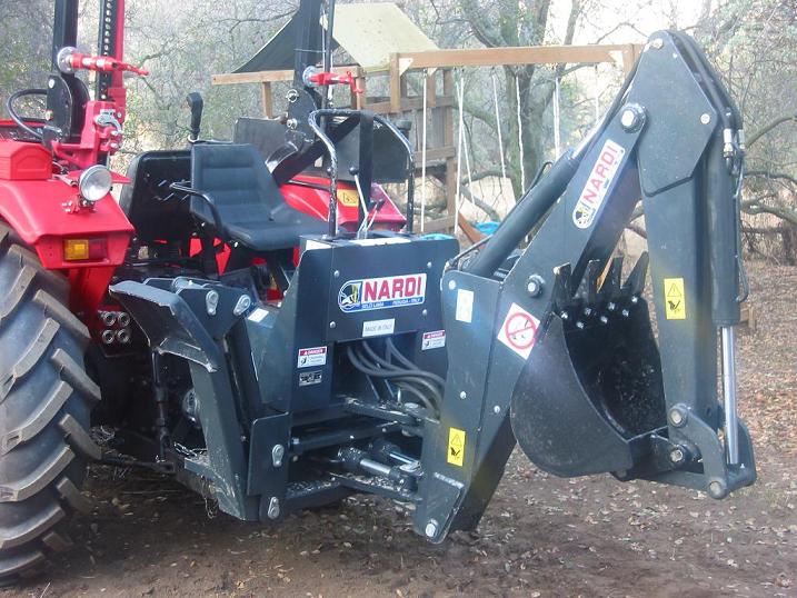

I will tell you that I've used my 7-1/2" backhoe on the 3pt mount without a subframe. I've used it quite a bit now for diggin' up stumps, roots, gutter and rocks out of my hard road. I estimate about 50 hrs max with the backhoe to date is all though. Anyway, I always tighten the 3pt hitch and side links up so there is as little movement as possible and the hoe sits "rigid" on the 3pt. I use the lower hole for the top link attachment. I also have it mounted to a pretty beefy 55 hp Kama.
I'll post a picture of the backhoe...a heavy duty Nardi weighing in at almost 1200lbs.
I will be honest and tell you that after reading the forems I have the same concern that you do in your post. I know there's a lot of stress there on the tractor housing and I don't want to break it. There was no sub-frame available for my tractor/hoe combination so I am trying to design/make one for it. I think it will be stronger and better and less stress on the tractor housing.... Just has to be better. . My plan is to get it made and mounted as soon as I can.
Yes, I use it now on the 3pt but I'd recommend getting the sub-frame with it if you can, or as soon as possible just to remove the possibility of damage to the tractor.

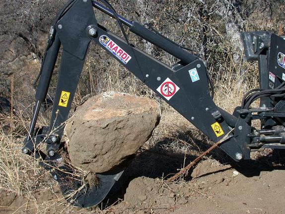

As you say, I'm one of the lucky ones (so far). When I asked the dealer about the need for a sub-frame he assured me that my Kama could handle the stress placed on it by the the backhoe...(of course he would since he did not have a subframe to add to it). Anyway, I had to repair damage to my road crossing the ravine caused by a wash out. That meant placing some pretty big rocks and re-build the road. So I decided to test it out, hoping that I would not break anything.
Here's a picture of one of the rocks I needed to place.
I sweated it out the whole way and luckily this was the heaviest rock I had to dig up and move. Like you said, I was fortunate but I was worried the entire time. I'll be working on the subframe design more now that this chore is complete. It will be a relief when it's done and mounted for my future projects.... Get a Sub-Frame
