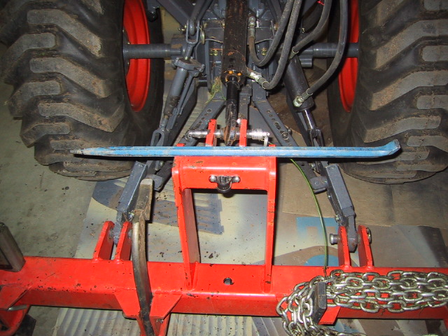

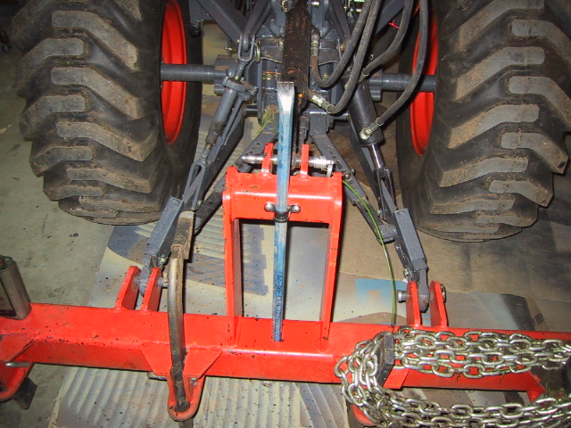

I have found that a pointed prybar is a big help in attaching 3pt attachments. It allows you to "pry" the implements into alignment with the 3pt attach points. Problem is, where is the prybar when you need it? I've lost two of them already by storing them in holes on the stabilizer bars but somehow they come out. Guess I'll find them with the mower some day. Anyway, I decided to do something about it today. I drilled a big hole in the box blade and drilled and tapped two holes for a clamp. Now I slide the prybar through the clamp and into the hole in the box blade (see photo). I couldn't find a suitable place on the tractor but I figure I'm either putting the box blade on, or taking it off. In either case, it's nearby. Best of all Harv, I didn't even use the welder!
Larry...
   / 3 pt Helper
#2
For some reason my photos didn't attach. Here is the first one.
Larry...
   / 3 pt Helper
Here is the second one.
Larry...
