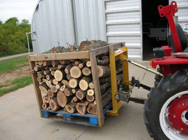

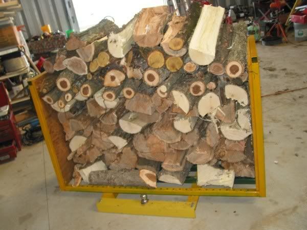

Here's mine, made from a TSC carryall. I used unistrut for the floor and back to let the wood debris fall out. I also put a 1-7/8" ball on the back to pull the woodsplitter. Works well for what I use it for.
   / 3 pt firewood carrier/carry-all #7
Bill,
Is the wood carrying part bolted to the TSC carryall in two of those photos? Those look like you used a pallet and framed it. Then in the middle photo showing the trailer ball it has sides to it and it looks like one unit now? Did you modify it to make it like that then?
I was hoping to see your Pontiac in that giant barn of yours too.:)
   / 3 pt firewood carrier/carry-all #8
Rob, I have two separate carryalls. I made the first one and found I had uses for another one. I use one like pallet forks, I drilled it so I can put a ball on it to pull the wood splitter. there is enought fork sticking out the back that I could attach a ball on it. I added about a foot to each side to make it long enough for a pallet.
