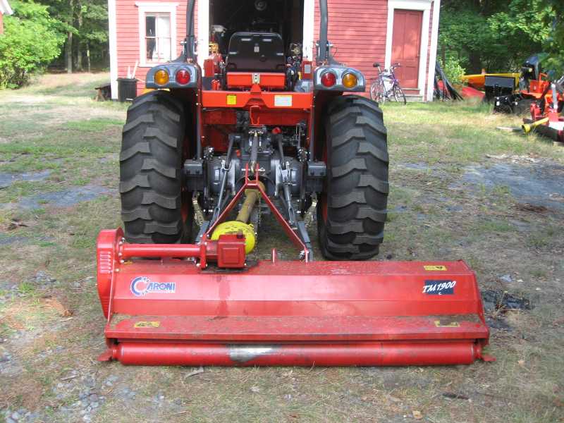

You may also want to consider a Caroni brand flail mower such as sold through Agri Supply. They also sell the deck mowers as well. I have the Kioti 72 inch RFM and am considering selling it for the flail mower. Folks here report a finish like cut but also tears up bigger stuff like a brush hog.
   / 3 pt Finish mower #10
It may not be exactly like a finish mower but it certainly cuts a lot finer than a bush hog and can go places you'd never take a finish mower.
