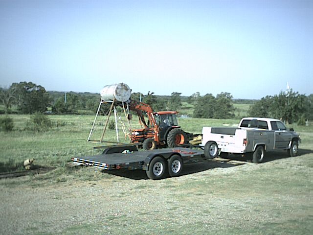

I can pick up 200 6' T posts in a bundle and move then around but need counterweight on back to avoid standing Kubby on its nose (HD brush hog does the trick but is in the way for close in manuevering). I unloaded my 300 gal o'head diesel tank from trailer with forks, just barely, couldn't have reached a whole lot higher. (see attachment)
