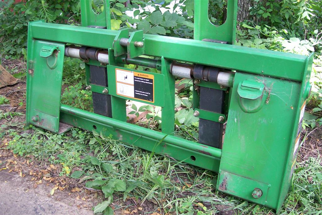

Anybody make a 3 pt adapter to allow using loader quick attach? I have the LA723 FEL with quick attach and want to use my pallet forks that have quick attach. I was thinking that the top link would allow tilt to slip into quick attach bracket. Is there one available for purchase or am I gonna have to create one? thanks.

Don't know how well it would work for your forks, but I just welded a bar (1 1/2") across my JD forks, and two brackets at the top to sandwich the top hook of the QH (iMatch for me).
Simple to do, and didn't add much extra weight.

Thanks much, that is exactly what I was looking for except for the price. I will probably build something or find one used.
