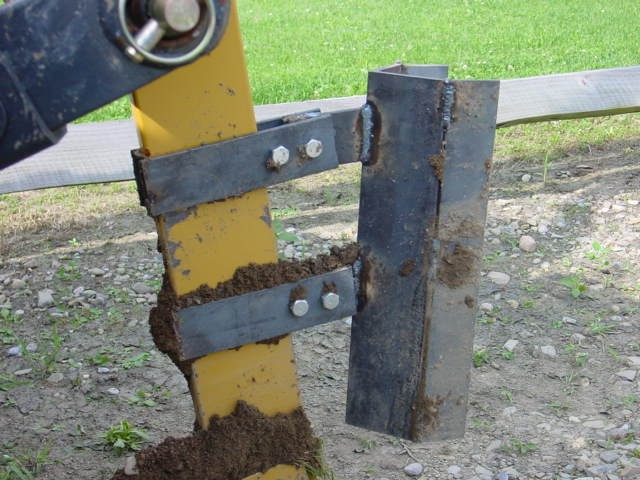

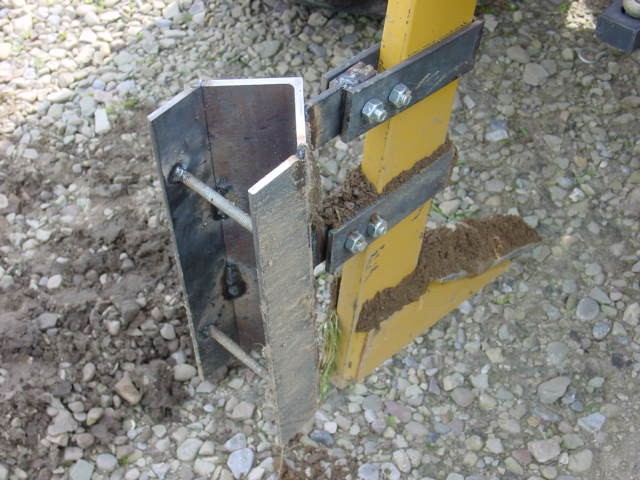

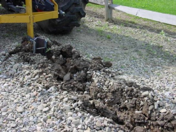

I used a subsoiler to bury a 1" gasline about a foot deep, Randy. I made a doohicky, which was probably overkill, and attached the gas line behind it on the lower crossbrace. Here's some pics of it and one where I was making a trial run, since I was going to be going across my driveway and wanted to see how it worked. All you need to do is drive over your trench to pack it back down then.
Those same brackets held a piece of conduit that was bent on a ninety when I ran some underground electric to my shed.
Just wondering, can you take the blades off of your middlebuster? Maybe you could get that to work somehow.

Flexible lines and wires are done very well with a subsoiler as stated. Rigid schedule 40 PVC does not do well when using this type of setup, from my experience. I just did over a thousand feet of rigid pipe and would up doing it with a middle buster with a small blade. Made a heck of a mess in wet spots and wished I had rented a trencher. Got lucky and found a almost new Ground Hog T4 with an 18" digging bar on it for $700 locally and will use that to finish another 500' of pipe this summer. Then sell the Ground Hog for more than I paid for it.
   / 3 point water line trench digger #6
I use a subsoiler. Run it empty to clear all roots and stuff. Then glue all your pvc together secure to subsoiler and pull away. works good here in Fl.
Thank you for the photos. I'm going to build something very close to that in the morning.
