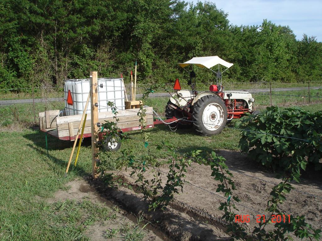

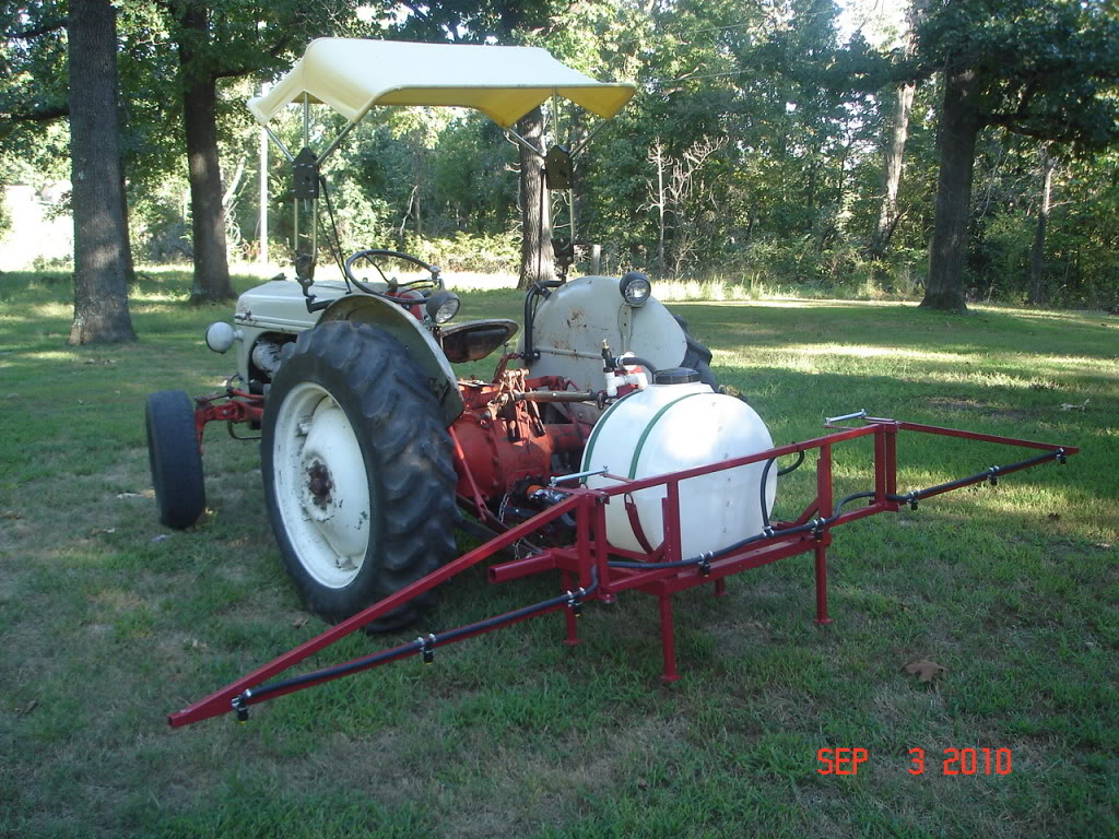

Most of the nozzles require a certain PSI, spacing, and height above the ground or brush to get the coverage/results needed for the application. A big majority of the chemicals sprayed are pretty corrosive. Size the pump to nozzles by finding the nozzles you want for the use intended, add up required GPM, and get a little bigger. If you go with a roller pump that's driven off the PTO, you'll have something with more uses than spraying brush, IMHO. I use the roller pump for my boom sprayer pump water from a tote tank, irrigating one of my garden patchs. This link will give you a bunch of good information, as well as diagrams for building what you want. TeeJet - Plumbing Diagrams Hope it helps. Mark
