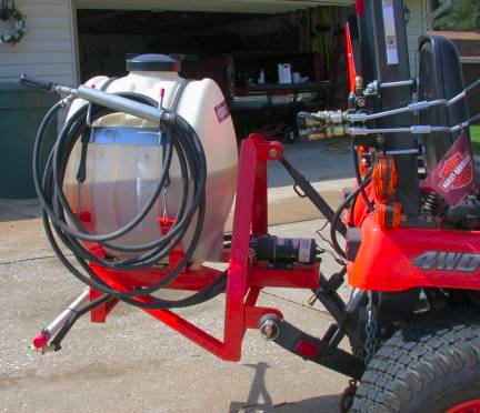

I converted an atv sprayer for a friends JD to 3pt, so I decided to do my trailer version for the BX. Here is a picture of what I started with.

Here is the frame I built that hooks to the 3 point.

Here is a picture of it put together

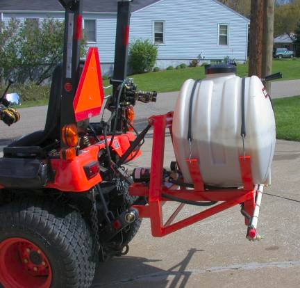

Here is a picture of the back of the sprayer, it only has two spray nozzles but they have a 110 degree spray pattern. After playing with the height of the boom and pump pressure it does about an eight foot path per pass.
   / 3 point sprayer conversion for a BX
Here is a veiw of the other side. I mixed up some 2-4-d and sprayed three of the neighbors yards to keep their weeds from coming into my yard. Then I mixed some bug killer and rode around the house and barn spraying everything with the wand from the tractor seat. It seems to work good, after I cleaned the pump inlet screen which clogged up. The sprayer has been sitting for years I didn't like towing the trailer for it. I always rinse the system with fresh water and run RV antifreeze through it. I do the same with the pressure washers and it seems to keep everything running properly.
Scott

Looks really nice. About how much did that set you back and about how long did it take to make it?
Seon, I understand about the need for a trailer on hilly property, you can build it with a low center of gravity and a wide axle for safety, I hope you have luck finding a tank locally that shipping is expensive.
Npaden, I made the frame from left over angle I had around. The only thing I had to buy was two cat 1 pins $4. It took two partial days to build, one day to cut, grind, and bevel all the pieces and the next to weld, prime, and paint.
Scott
